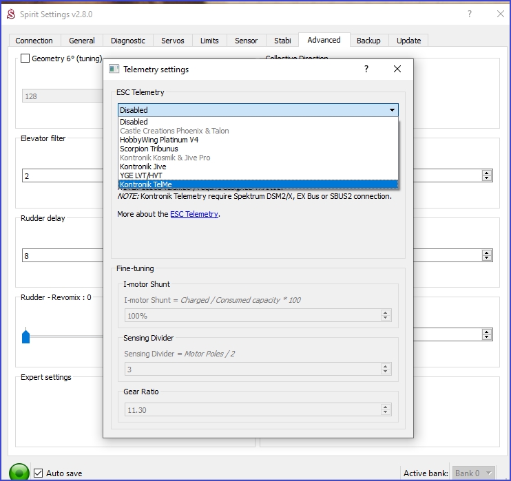

While trying to get a 4651T to stay bound to my DX9, I noticed that the ESC telemetry menu where I changed "disabled" to Talon when using the 4649, is grayed out?
See image here:
Is this option not needed when using SXRL2 and 2.8.2 FW ?
I have the resistor wired into my ESC cable to provide the ESC telemetry data.
Posts: 12988
Please assign Throttle channel in the Channel mapping.
