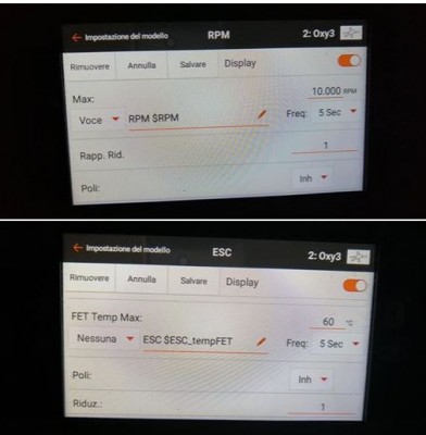

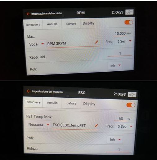

Another question, in the telemetry section of my radio, I entered 1 as a value to have the exact same rpms of the governor and the spirit, on my radio, while more than one person wrote to me that 10 must be used.
I tried but if I enter 10 instead of 1, the values ​​appear as tens and not as hundreds.(inserted attachment)

2. Never set any Gear Ratio or Motor poles in the radio. Always only in Spirit unit.

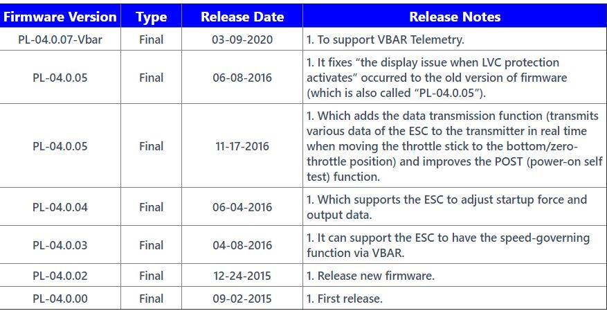

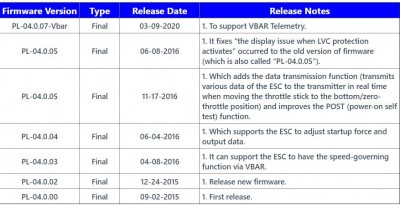

I solved
I'm another victim of the latest Esc hw V4 update to Vbar version
Hobbywing Company writes the manuals with his feet, and in the history of the revision of the updates the current version(my esc 60 amp v4) before the Vbar is also missing, that is the 04 00 6(see Attachment)
I went back to the previous version(04 00 6) and now the telemetry and the Uni telemetry cable works fine.
