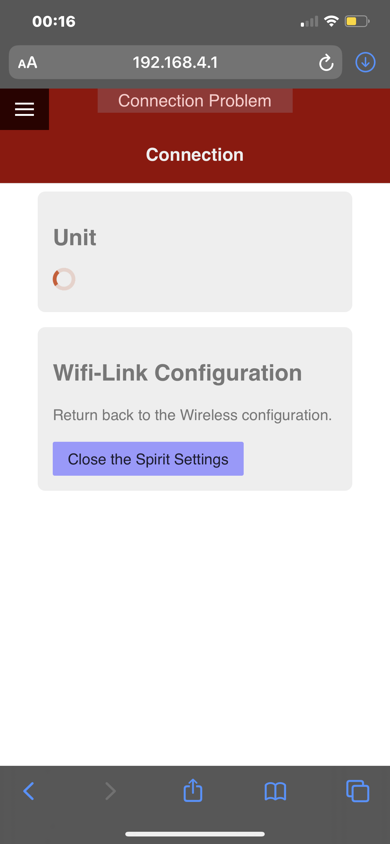

1. when using usb to connect the SPIRIT 2, spirit settings windows app can be used without issue.
2. I can connect to WiFi of the „WIFI Link“ module, and the basic WiFi status web page through the 192.168.4.1.
3. All SPIRIT 2 and WiFi link firmware are just updated to the newest Version.

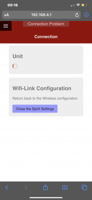

4. the Problem ist: the SPIRIT Setting Page cannot be access, it shows all the time “connection problem”. I suppose the WiFi link cannot access the spirit 2 unit. I checked all electric connection, it seems ok.
Could any one help me? Urgent waiting, Thanks in advance.

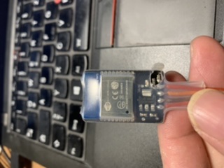

if wifi module is old, you have to remove two resistors

Thanks!!! It works great now:-)

The 2 serial resistors of tx & Rx were 1kOhm.
Now just short it, then works fine.
Supposedly the SPIRIT 2 might have integrated these resistors.
