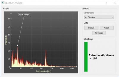

I did the vibes analys in software 3.1 Spirit RS without blades,and the text says extremley high vibes in ele and yaw 110%,the ail ok.but the graph shows only 22% in ele and yaw.the TX jetis log shows 10%.I removed rotorhead and swashplate the text,still extremley high vibs 110% the graph 16%.
In Spirit pro when i did the analysis it never excides 14% in graph and the text says the same.
Can someone explain whats going on?
//Latjo

I run 3.1 on both the PRO and RS,what i mean whith text is the text to the right of the green bar.
Attached is a screenshot when the motor is running whitout blades,its Electric.
//Latjo
Posts: 12988
Oh,
could you make sure that the PCB (electronics) in the Spirit enclosure is really holding steady?
It should be possible to check with a connected servo connector.
From the plot it look like this issue. Or the cables are hitting the case somehow.

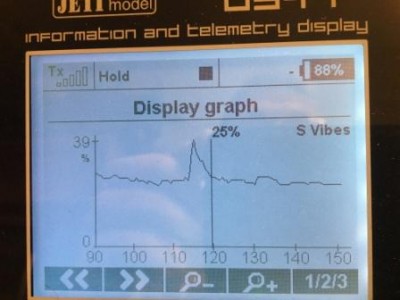

Attached is a foto of vibes from flight today, DS14

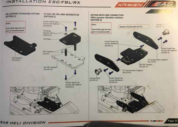

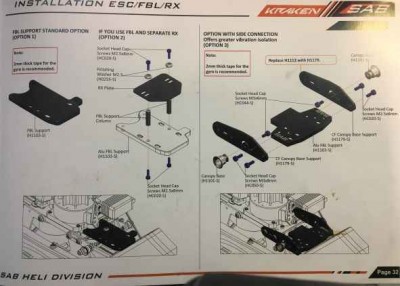

The viberation problem whith SAB Kraken and RS is solved.In the kit there are two options.I chose the left one,but
the plate is attached direcley on the gearbox not good,the other,the right one offer a vibes fri attachment.
After changing to the right solution the vibes is max 30,software says OK.
