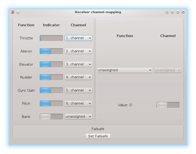

Posts: 13056
Can you confirm that all channels are moving properly in Step 5?
Please take a look at the screenshot in the attachment. Is this identical with yours?

All channels are now moving properly in Step-5
I tried several times to add pictures to me response, but for some reason I DO NOT manage. The page accepts my upload but it actually doesn't show my pictures, why?
THe channel assignment I had to make to get to all channels moving properly, based on your creen shot image , in my case it is : 1,3,2,4,5,6,7
I had to swap 2/3 because the sticks were performing the opposite function, not clear why???
I will try now again to upload my image, but I hope you can understand my setup and help me with my latest questions above

Posts: 13056
You have to select image for upload and then click Attach file.
And then send the post.
If Aileron bar is moving while moving with Aileron stick and Elevator bar is moving while moving with Elevator stick then all is OK.
So then you can continue to another step. No changes in the mapping, channel reverses should be performed in your radio from that moment.
