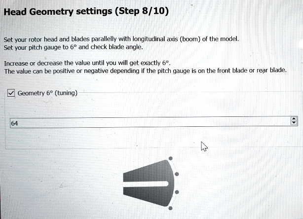

I managed to get past all the steps to this point, I have both blades at 0 degrees over the tail boom with a small gap between them, all the sticks work the correct directions.
Tilting the machine gets the correct reaction of compensating from the unit, including the tail rotor.
But, I do NOT manage to get the 6 degrees. When I change the box (in stage 8) I get to the end of the selection - at 64, but the pitch is at 8 degrees, not 6
What can I do about it?
End range, but 8 degrees, not 6

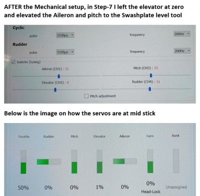

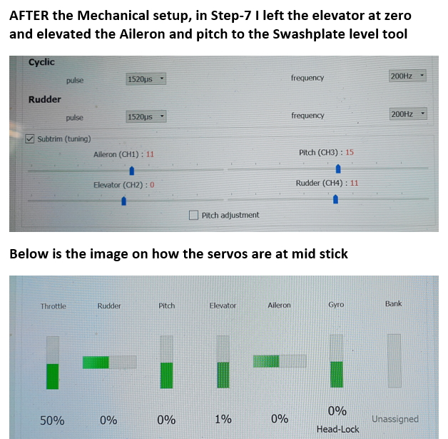

Hello again,
OK, started all over again from scratch:
1) In the Spirit, I made ZERO all my cyclic adjustments
2) Moved the servo arms to the best position close to 90 degrees
3) This made the elvator to be a bit higher than the other 2
4) The gap from the tool was less than 1mm
See details in the combined picture below
5) Then, after the mechanical setup as close as I could, I adjusted the Ailerone and Pitch to level with the Elevator.
6) During this time, all the sticks are position centered
See details in combined picture below
7) Removed the swash level tool, installed the head with the blades
8) Moved to step 8, the angle is NOT even close to ZERO degrees....
I must be doing something wrong here
What?

In step 8 you are going to be looking for the elusive 6*. You change the number in the box on screen and the blades will change pitch. Do that until you see 6* on your pitch guage. Then hit 'Next' to go to step 9.

buttles wrote:In step 8 you are going to be looking for the elusive 6*. You change the number in the box on screen and the blades will change pitch. Do that until you see 6* on your pitch guage. Then hit 'Next' to go to step 9.
Yes, I checked for zero in step-7
Yes, moved to step-8 but the best I managed to get to was 8 degrees when the boxed reached 64 and would not go any further.
Is it possible that the zero of my swashplate is far too high (too long push rods)?
