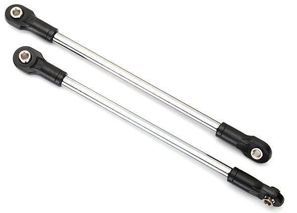

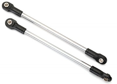

Can you take a photo of your model? I have not seen swashplate with not adjustable push rod.
Please note I am talking about things like this (attachment).
