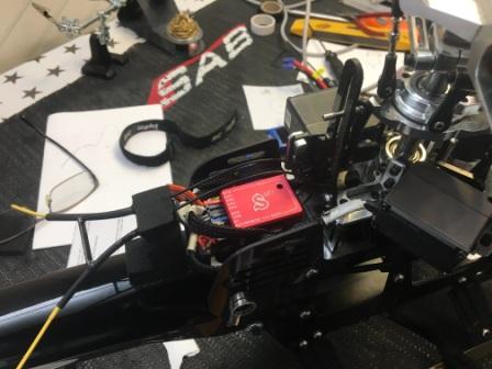

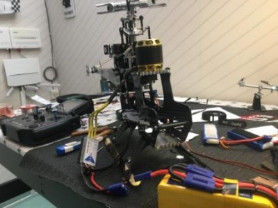

HI
I have changed to jeti and spirit rs in my helis,the kraken performs whell but not my G570.
Cant get the governor to work whith Spirit RS YGE 90HV.The governor works fine befor whith spirit pro and
firmware 2.8
When i have the window general subwindow test(governor)open and unit connected to computer the governor
works fine.I have set f-mode norm=1800rpm idle1=2100rpm idle2=2400rpm the setpoint changes fine and
the rpm follows.
But when i close the testwindow and changes f-mode the rpm goes to maximum 2500rpm and stays there,
i open the widow again and se the setpoint changes in testwindow but not the rpm.
I discover this phenomena when the heli whas in the air.I havent done any changes in cables or in the esc.
I can se in the log noisy rpm signal sometimes but that whas the the same whith spirit pro.
I have also moved the esc out from the heli to be sure that no interferens from esc motor.
the unit is powered by 7,4V lipo.
