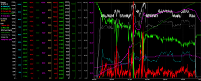

as there was a lot discussion in the last weeks around temperature values reported via Hw telemetry (and me too i was not confident about the measurements), i did a slight test: i have mounted a j-log(s32) in addition to Spirit 2 telemetry on my Logo444SE and both had the chance to give their telemetry-values at the same time out of the very same flight.
attached you can find a pic of the log (if you need the full log, no problem) - i have configured same colors for same values: as you can see all common values do match +/- perfectly, the only one being not OK is the purple one: Spirit temp. quickly was up at 93°C and j-log reported a max. FET temp. of 48°C.
... all the people used to (~ coming from) other telemetry implementations are afraid of burning down their Escs ;)

nb: test-setup: the Hw80 v4 was connected as normal with Spirit 2 telemetry cable. Spirit is connected via EX bus to Rex3 (E1). j-log S32 was attached to Rex3 / E2 and the signal wire only (orange) of the Hw's telemetry port was y-cabled to j-log's signal in. so both telemetries worked in parallel.
