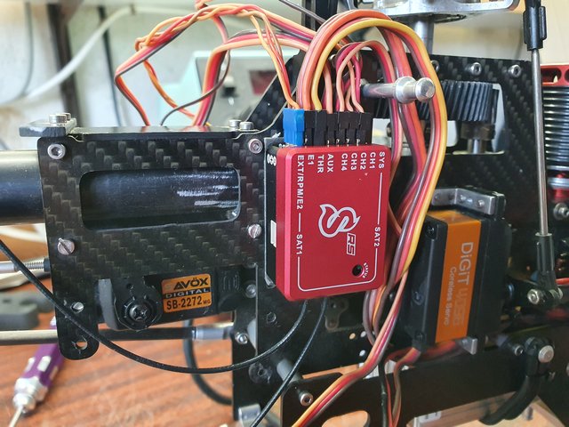

Any reason why my preferred mount option is not supported?
I would be happy to have a vertical mount option available.
best regards
Alois
Posts: 12988
each model has designed spot for gyro mounting. This mounting position is designed so to allow the best conditions for the unit.
Normally any such position is not recommended for a various reasons. For example because aileron axis can achieve the highest vibrations and overal acceleration. Model can do a very sharp movements in this axis. So placing unit in this way will cause to bounce it bigger than when mounted normally.
Also such position is very insecure.

ZeXx86 wrote:Hello,
Thanks for the information!
