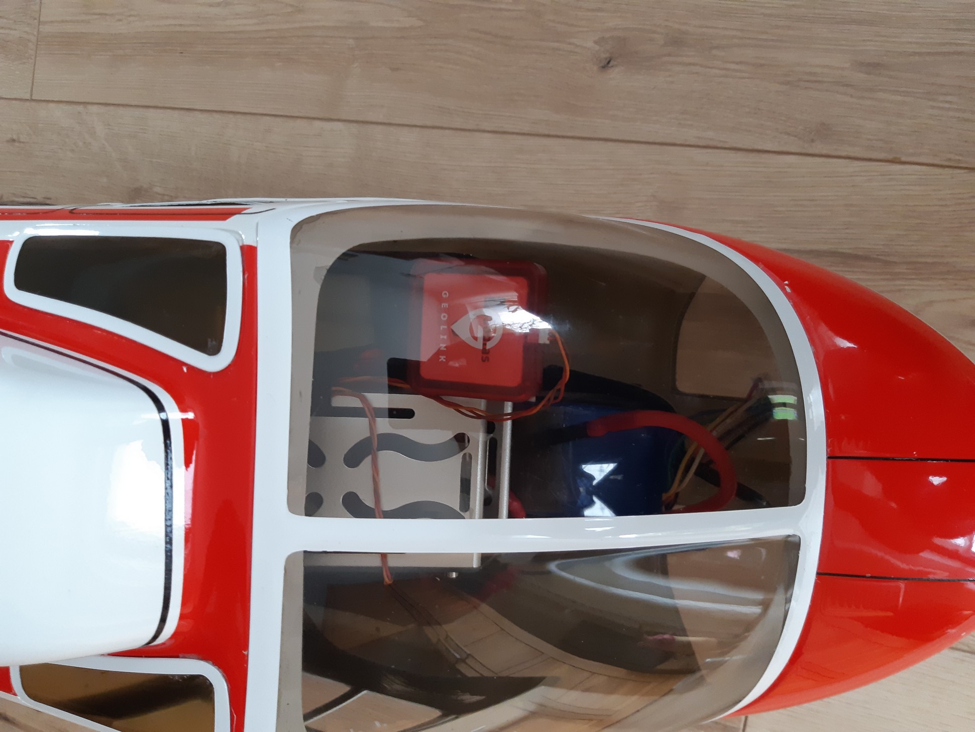

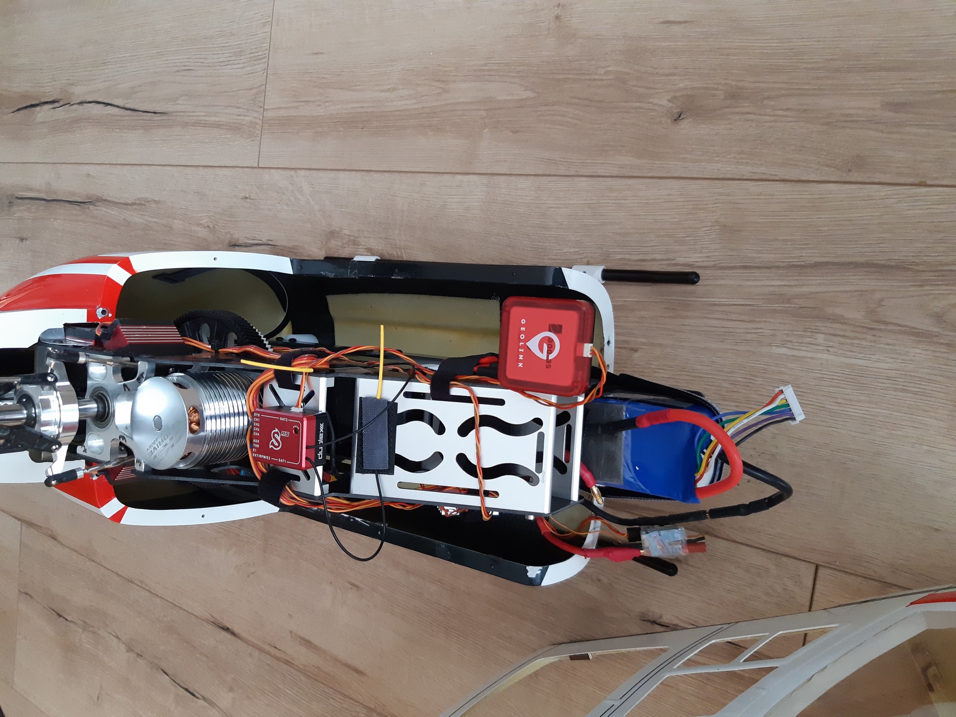

Magnet and geolink don’t go together too wellheli_5200 wrote:Here is the installation position.
The hood is attached with magnets. The compass shows 90 degrees when the nose is pointing north. The cure was 17 degrees
greeting
Hello,Trek nut wrote:Magnet and geolink don’t go together too wellheli_5200 wrote:Here is the installation position.
greeting
they are more than 15cm away. It has no effect on the Konpass. at least when I try it on the table.
