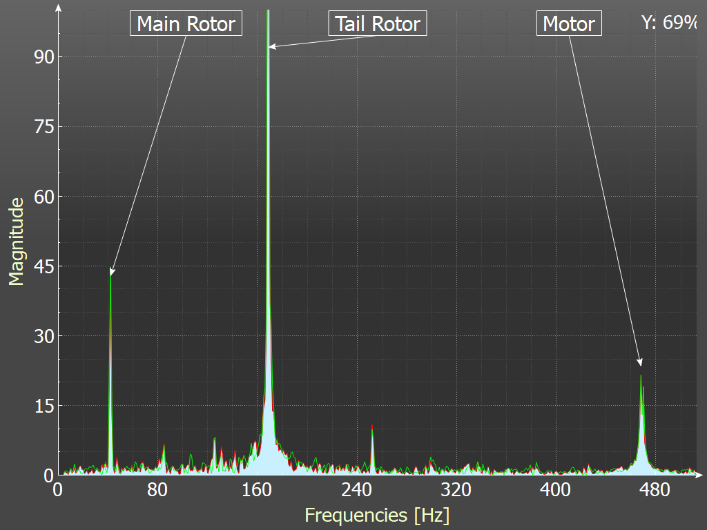

It's been suggested that vibrations are the cause. Looking at the telemetry 'S Vibes' from the SpiritRS the value is a fairly constant 40% +/- 5%. This is similar to my other helis, so I can't see it is excessive. I can post the graph if necessary.

yes, please attach vibration plot especially from Y axis with tail blades on ideally.

Here attached is the vibration file for the Y axis. I have checked the main shaft for straightness (in lathe, with test indicator) and it is OK. Perhaps I should get new tail blades, although the plot with/without them is similar.

Your tail rotor vibration is very high according to that picture.
Look at the diagnostic tab/spectrum analyser section of the manual:
Generally, the vibrations are the highest on Y axis (aileron) but we recommend you check all axes each time you are doing measurement. However vibrations should not exceed 50% for all axes at any time. In the case vibrations are at 90% or more, the model has an issue that needs to be rectified. Should the magnitude exceed 90% on any of the given axes, it is recommended to fix whatever issue is causing these extreme vibrations before flying the model. Even though Spirit FBL unit is highly resistant to vibrations, these could cause unwanted interactions
Sent from my SM-G950F using TapatalkVibration levels:
Vibrations up to 50% - vibrations at a normal and acceptable level
Vibrations between 50% and 90% - raised vibration levels
Vibrations exceeding 90% - extreme vibration levels
As well as overall vibration levels not exceeding 50%, any specific frequency (peak) should not exceed 50%. Anything above this level should be cause for concern and requires further investigation
Yes, agreed - thanks. I'll work on reducing the tail vibration and will be pleasantly surprised if it fixes the issue, particularly as I still have the swashplate tilting left on "Rescue" without the motor on, after a fresh, level initialisation. Stranger things have happened, though, and I've been 'surprised' before!
