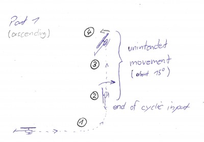

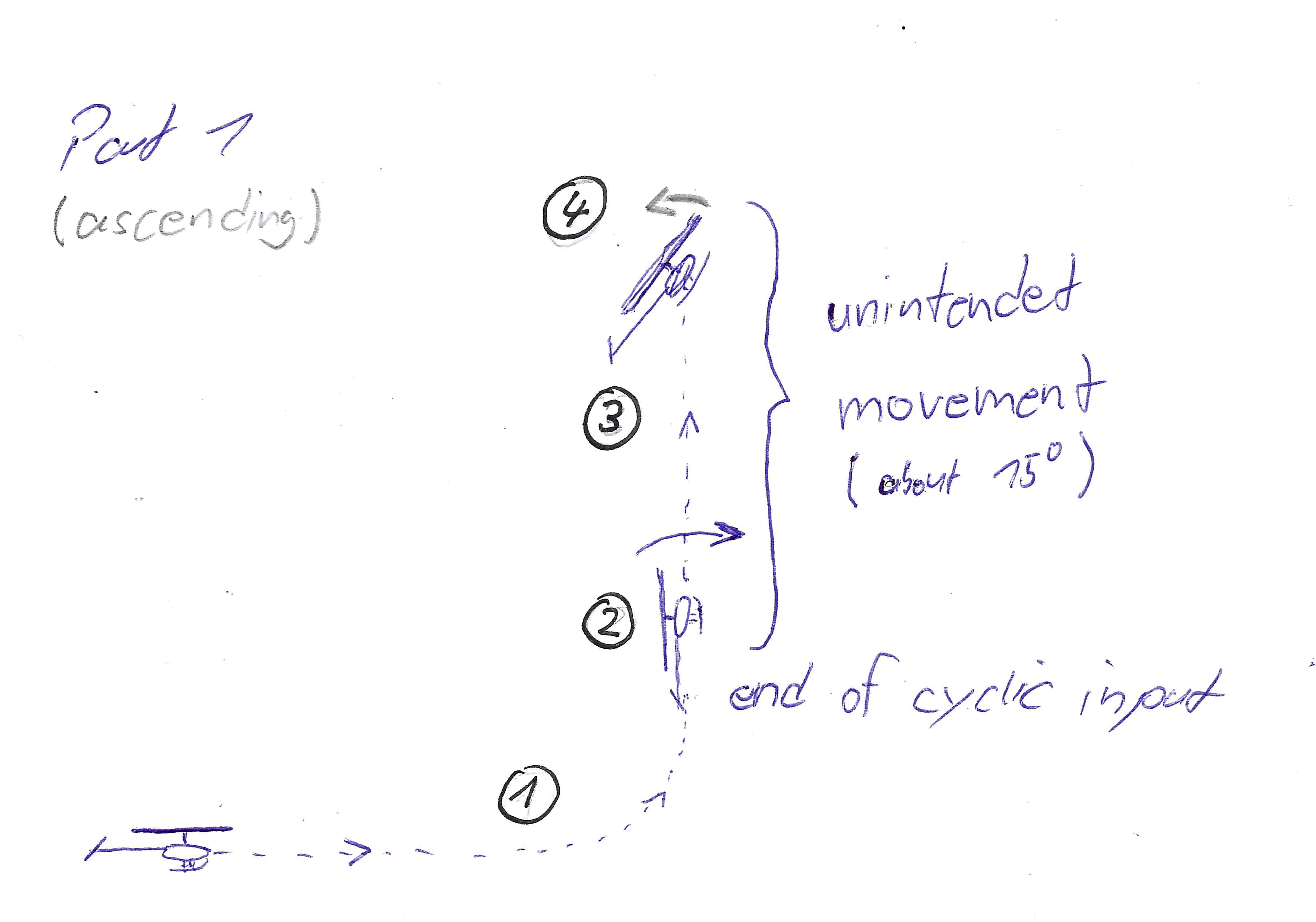

Let me try to to explain my problem using the "(Double) candle with descending flip" as an example:
I splitted the manoeuvre into two parts in which two different issues occurred.
Please find two drawings and my settings attached.
wraith-E760-bank2.4ds
(255 Bytes) Downloaded 404 times
Part 1:
(1) – Helicopter flies straight and pulls into a vertical ascend performing a quarter of a loop.
(2) – At the end of the quarter-loop (when the helicopter is vertical) I instantly stop pulling elevator.
(3) – From now on the heli tilts forward smoothly to an angle of about 15°.
(4) – As a consequence I need to adjust the position that it is exactly vertical again. That is a problem because for the judges it's a mistake and the manoeuvre will be downgraded.
What I did: I played around with cyclic feed forward and flight style to reduce that behavior. With the attached settings I achieved the best result. But I was not able to get totally rid of it.

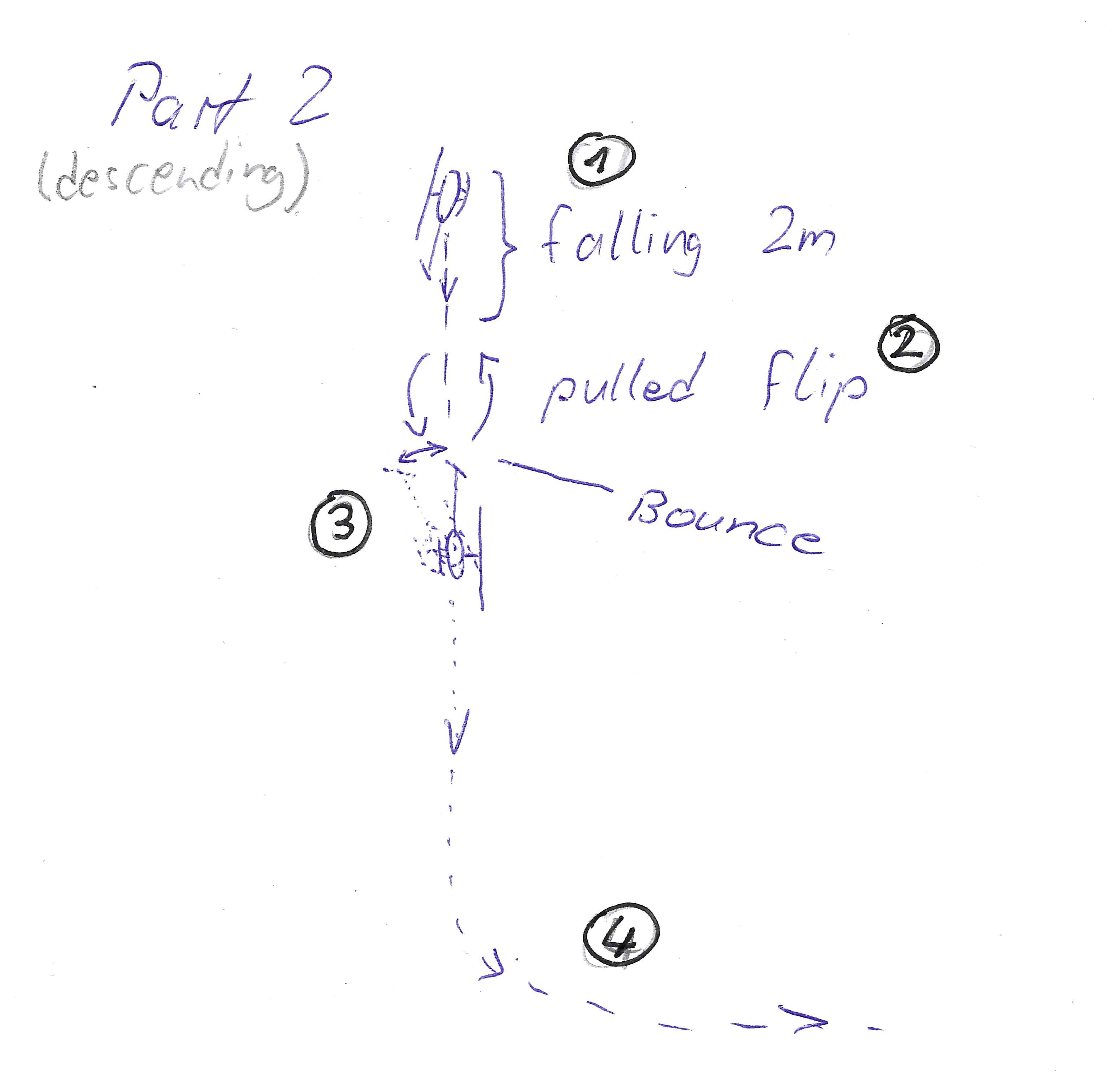

Part 2:
(1) – After my adjustment and a nose up stop the helicopter starts falling backwards vertically for 2m.
(2) – The heli performs a half pulled travelling flip.
(3) – When I stop the heli after the flip it flips too far and instantly bounces back to the intended vertical nose down position. That bouncing should not be either.
(4) – Afterward the heli pulls again into a straight horizontal flight.
What I did: I increased the elevator filter to 4, what improved the flip-behavior but it could not eliminate the bounce.
Thank you in advance for your help!

I have tested today my spirit DS with the figures from Frieder.
I must say, that I have the same problems.
For e.g. with the candle.
After I pulled the helicopter fast in a vertical ascend I stop the elevator. After this my helicopter tills about 15° without any stick input.
After this I have tested a second helicopter with a NEO and there are no such effects.
It would be nice when you can give us some hints to solve this issue.
Björn
Posts: 12988
the problem you are describing is likely due to geometry correction which is active all the time and is learning from how the model flies.
I guess the problem happen because you are moving with the collective pitch which plays important role in this correction. This helps to eliminate several unwanted phenomenons that are common for FBL units.
Could you try to not move with the pitch too?
You could resolve the problem by decreasing Geometry 6° value which will make all corrections less apparent.
Or we can send you special firmware where these corrections are turned off.
heliflieger8587
Posts: 23
Joined: Fri 28. Aug 2020 9:11:55
so for my understanding... The 6° geometry value only works for automatic corrections. So the full control will be available and only the automatic corrections will be decreased. Is this right?
So if we have for e.g. a version without this 6° value (or zero), we must correct the flight line of the helicopter self.
Or have we some additional effects?
