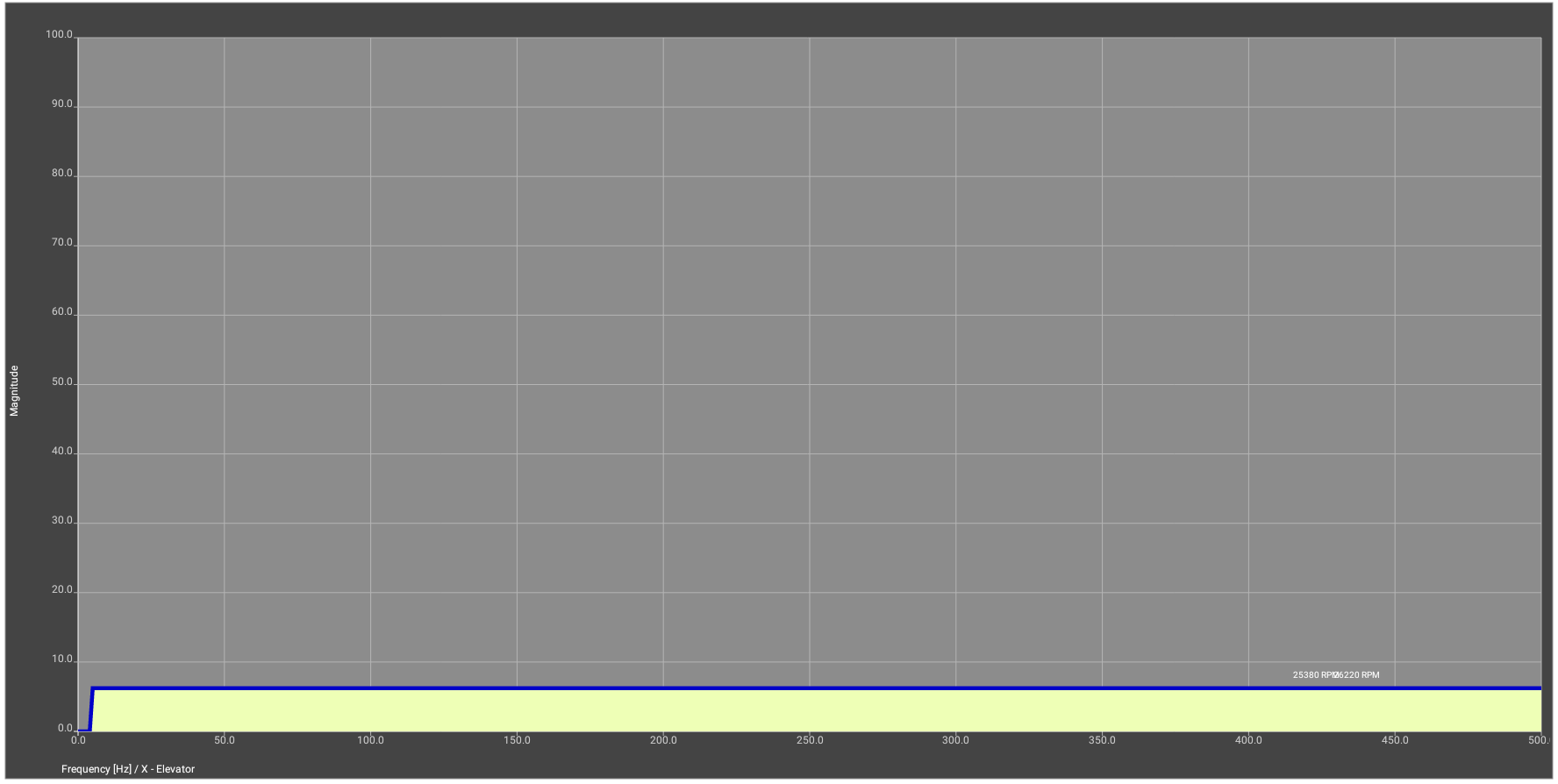

Hello, I have spirit 2 with software 3.1.0. I check the vibration level when the helicopter is stand stable on the table, the motor is off, the servos are stop. I do not touch the model and I see the general vibration level up to 20% - 70% on all axis. Sometimes I see 999%. Vibrations are appear and disappear. Why? What is wrong? I paste photos with all axis.

Yes, I know. I have one old module wifi and one new module wifi. In old module I have unstable conection with my one spirit 2 unit but do not have this topic problem. This problem I have in new module with one other spirit 2 unit. I will check this spirit 2 with usb connection and PC app and write to you my observation. I have also this type graph as below.
