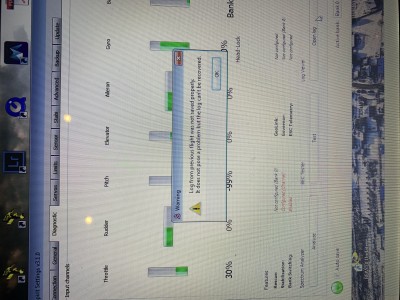

I have a problem with my spirit 2 system.
A few flights ago, i crashed my heli - when I was hovering, the helicopter crashed into the ground with full negative pitch. I dont know why my heli do this.
I rebuild it, and today i did 4 flights.
2 times i have a strange situations - when i do a tictoc, my heli „rolled over on his back”
And it took him about 2 seconds to get it on normal position. I have the impression that he did not respons to my commands In this 2 seconds.
In the last time I crashed the helicopter, and today, when I had problems with it, I wanted to read the logs and I got this Message.
Is there something wrong with my spirit?
To this day, I don't know what caused the last fall, or what caused today's problems but i didn’t read it...
Posts: 13054
we are sorry for the troubles.
I highly do not recommend to fly until the problem will be found.
To be able to help you we will need to know everything about your model.
It could be caused because failsafe was triggered for some reason. So you can try what will happen, when you will turn off radio.
When collective pitch will go?
When unit is turned off, it is moment when it is saving log to the memory. When for example something caused a short or voltage was discharged very quickly, the unit will not be able to save the log completely. So then the message will happen.
You can retest it just by turning off your radio. When you will repower the unit then after next Log opening it should display the log with receiver signal loss.

My failsafe is engine of and pitch -12, i tested it when i crashed a heli, but i cant read a log...
~3 weekend ago, I read the logs without any problems, it was signal lost, it disappeared after replacing the satellite cables. there were no problems at the time other than these errors
Now i cant read log from previous flight, i must test to read the log when i turn off the radio.

Now, When i testing the failsafe - cut Off the transmiter, i can normally read the log after restart heli, i have a error with signal lost, and low voltage when I disconnect the battery - the log is normally saved in home, but not When i have a problem on flying field and want to read this logs after back to home..

failsafe could be the reason for my model crash, but then spirit should show me in the logs that it lost the signal, and it did not do that either after crashing the model or after yesterday's flight problems. Yesterday definitely failsafe did not work - this was not the behavior of the model in failsafe..
I don't know what was wrong when I crashed the model, but now I'm afraid to fly it, and the spirit itself in this situation makes any diagnosis difficult for me ...
