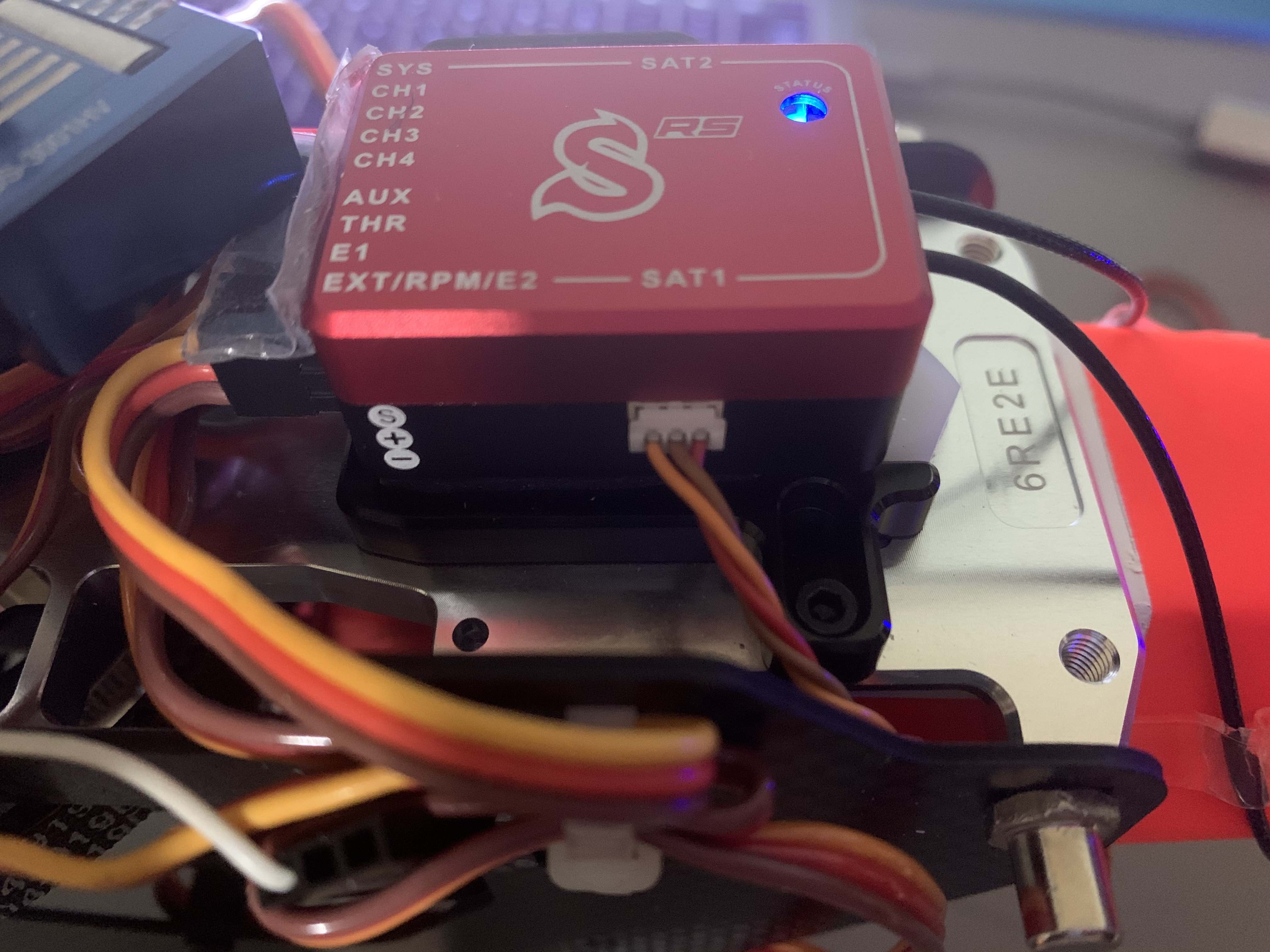

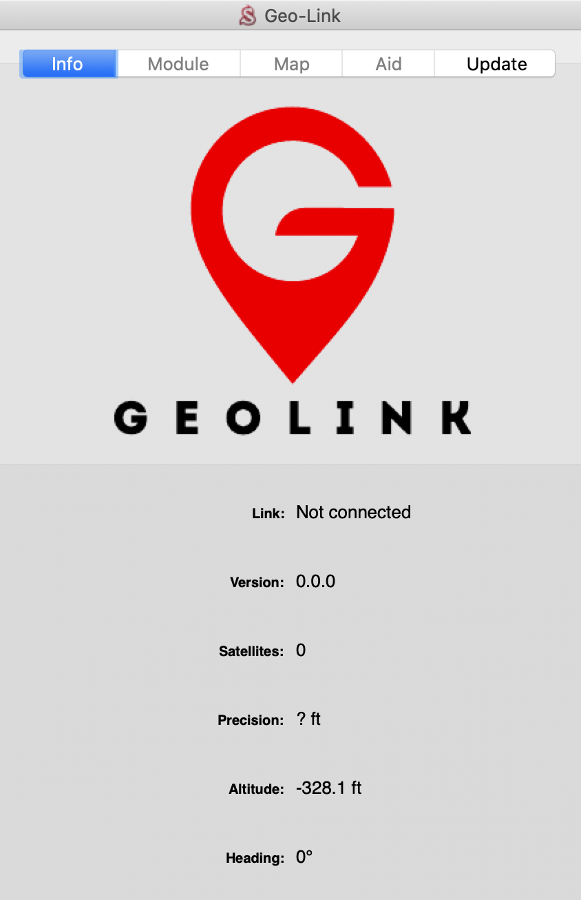

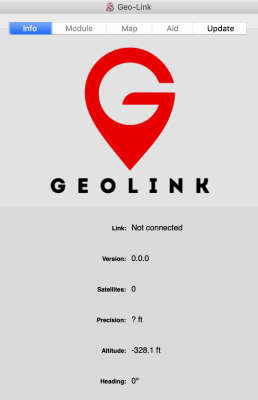

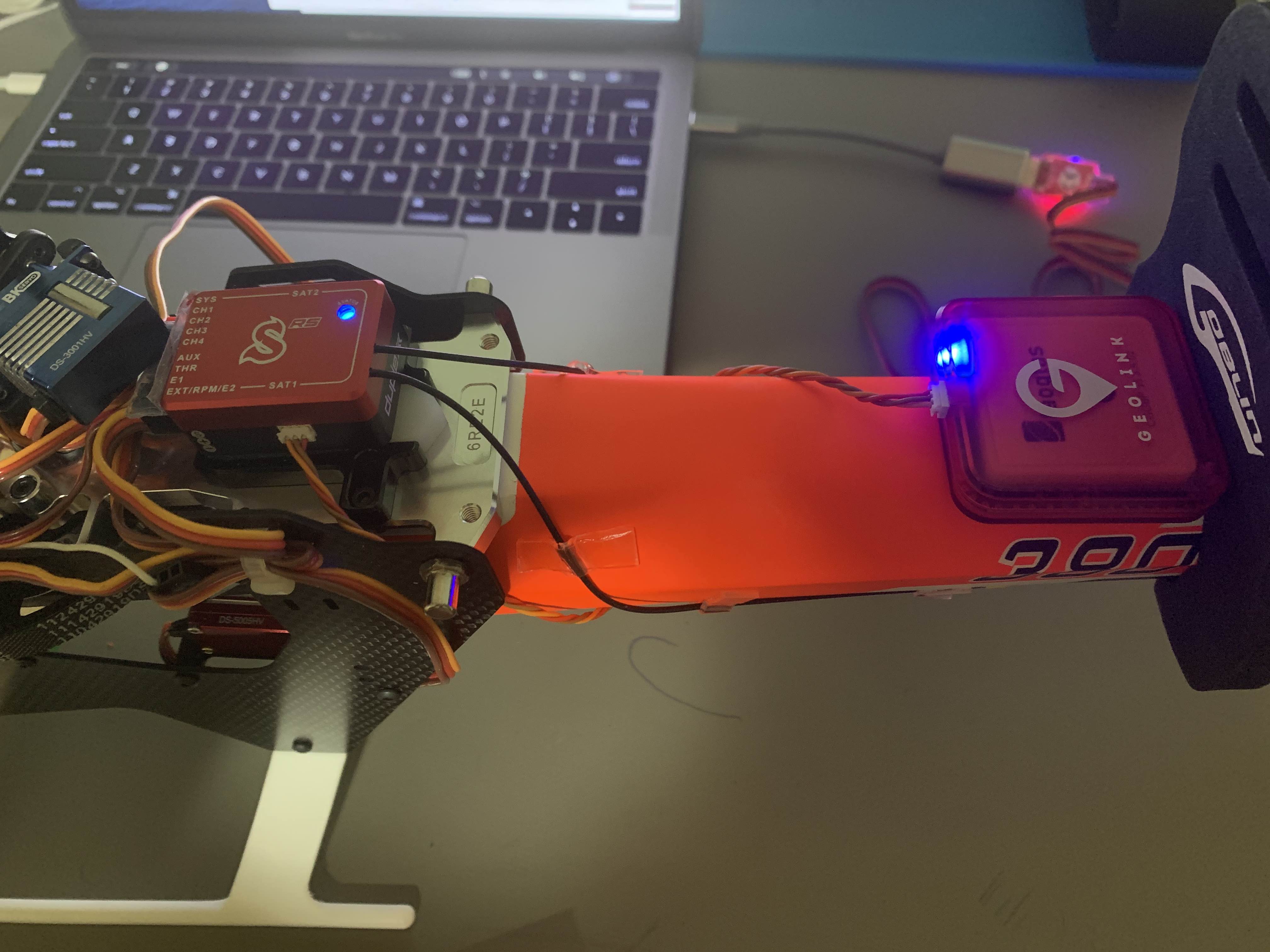

Unfortunately, my Geolink is not detected. Geolink is connected to SAT1 of Spirit-RS unit. Within a 15-20 sec upon boot up Geolink is solid blue. When I connect USB cable to SYS-port on Spirit-RS and startup Spirit Software, then open General (Geolink Module is enabled). After I click Settings it says: "Link: Not connected". Note that the light on Geolink is still on (see attached photos).
What should I do? How can I get my Spirit unit to be recognized? Let me know if any additional information is required.

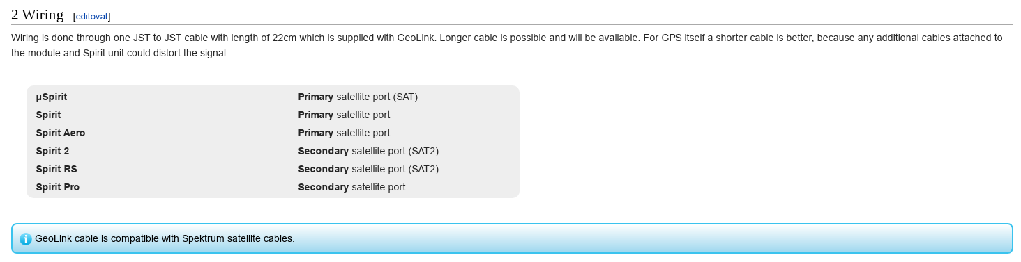

Geolink goes into Sat 2 on the RS. In the manual.......
Posts: 13054
Yes, all described in the manual :)
See attachment.

Oh-god! Forgive me! I did not realize there was sat2! :) I saw it, but I was soo excited I plugged it without double-checking! Thanks all for the quick reactivity. The unit has been updated to the latest firmware and I am now playing around like a kid in a candy shop!
