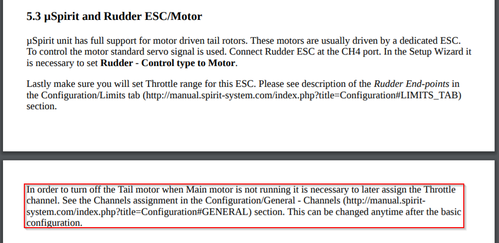

I am during setup process of uSpirit unit with a motorized tail.
I have the following issue: I can`t understand this part of the manual

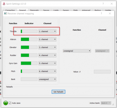

this is my current channel assignment
With this current setup even if I have throttle hold active the tail will move if I move the rudder stick.
My expectation is that tail motor should never start if throttle hold is active.
What do I need to setup to achieve this?

10x wrote:Have a read in this thread....http://spirit-system.com/phpBB3/viewtop ... =24&t=4259
yup, thanks.
firmware http://spirit-system.com/dl/fw//spirit-fw-3.1.10.4df
fixed my issue!
