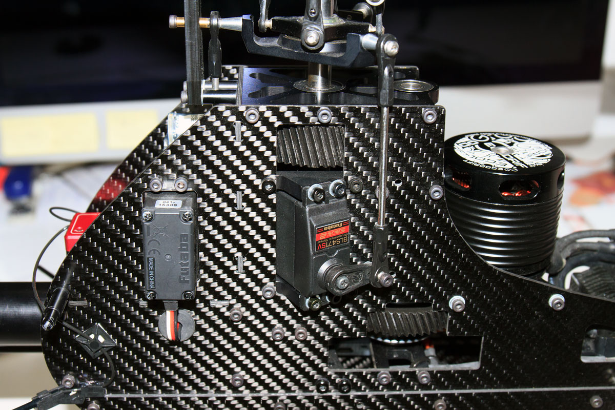

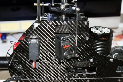

it look like too high Geometry 6° value.
This could be responsible for the issue.
It should be maybe 1/4 lower from your description.
When you enter Subtrim (tuning) are all servo arms in the middle and pitch 0° at the same time?
For this model elevator filter 3-4 should be used.

6° is perfectly 6.0° with rotor blades in longitudinal axis... measured on the blade above the boom or the blade in front.
all servos are perfectly centered (all pushrods are measured +/- 0.1mm same length) and 0° pitch in subtrim menu... swash perfectly leveled.

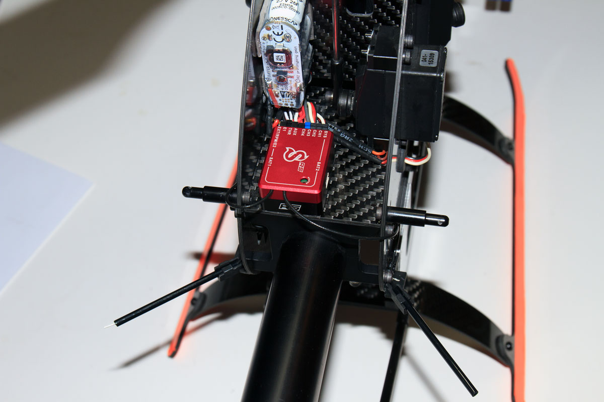

I would recommend to make sure blades are not too tight in the blade holders.
Is unit mounted hard at the model? (no wobbles)? For example sometimes a cables or plugs are touching the unit. This can then make the problems.
Also antennas should be ideally mounted as far as possible from the unit - not too close to the unit.

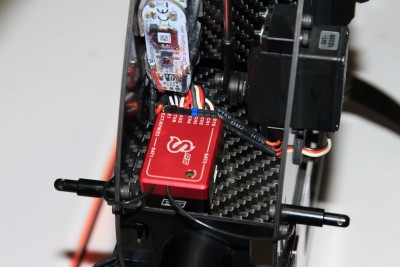

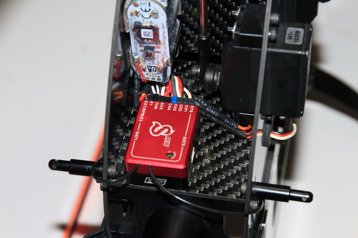

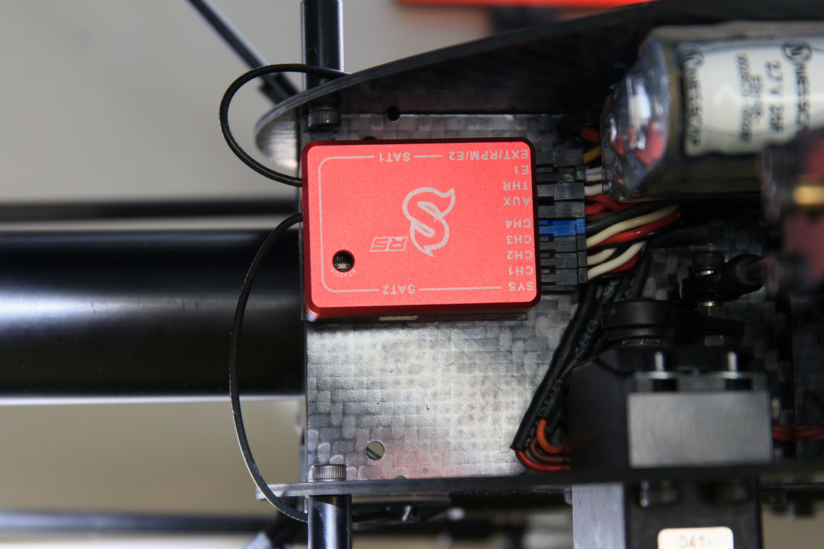

the unit is mounted with 1 layer of supplied tape as recommended - see mounting situation in pics attached. antennas are loosely mounted to go downwards (in a bow) below the (extralong) Diabolo canopy. i've attached a picture (next post) of servo geometry too - just for you to check. it's all as per the manual of minicopter. any thoughts?

HeliMLM
Posts: 370
photo of servo geometry
cheers
Michael

Posts: 13054
for me it look like the cables are too close around buffer pack. Nothing should touch the cables near the unit.
Antennas are bent little bit more than they should, but this is likely causing not the problem but can damage the antennas.
From photos I would recommend to place buffer pack more upwards or to a different place where no touching is possible. But maybe I am wrong.
These are probably the only things that seems to be odd from the photos.

Hello Tomas,
you're right - from the photo (due to tele-lens) it really looks close with cables & buffer pack. i've checked and in reality there is 4-5mm between pack and the cables. i will anyhow set the pack 1-1.5cm higher as i can better access the cables then... was not really smart to mount it that close. in addition i will mount the antenna over the boom like with the other helis just for at testflight. just to 100% exclude that too... it's last hope 8-)

Another option is to try a different Spirit unit you have to make sure it is not related to the particular unit.
Could you mount antennas so they are more or less directly, without a bending? At least for hovering tests.
It is enough to mount ends with a tape.
