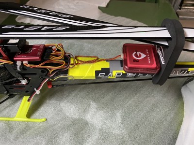

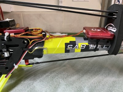

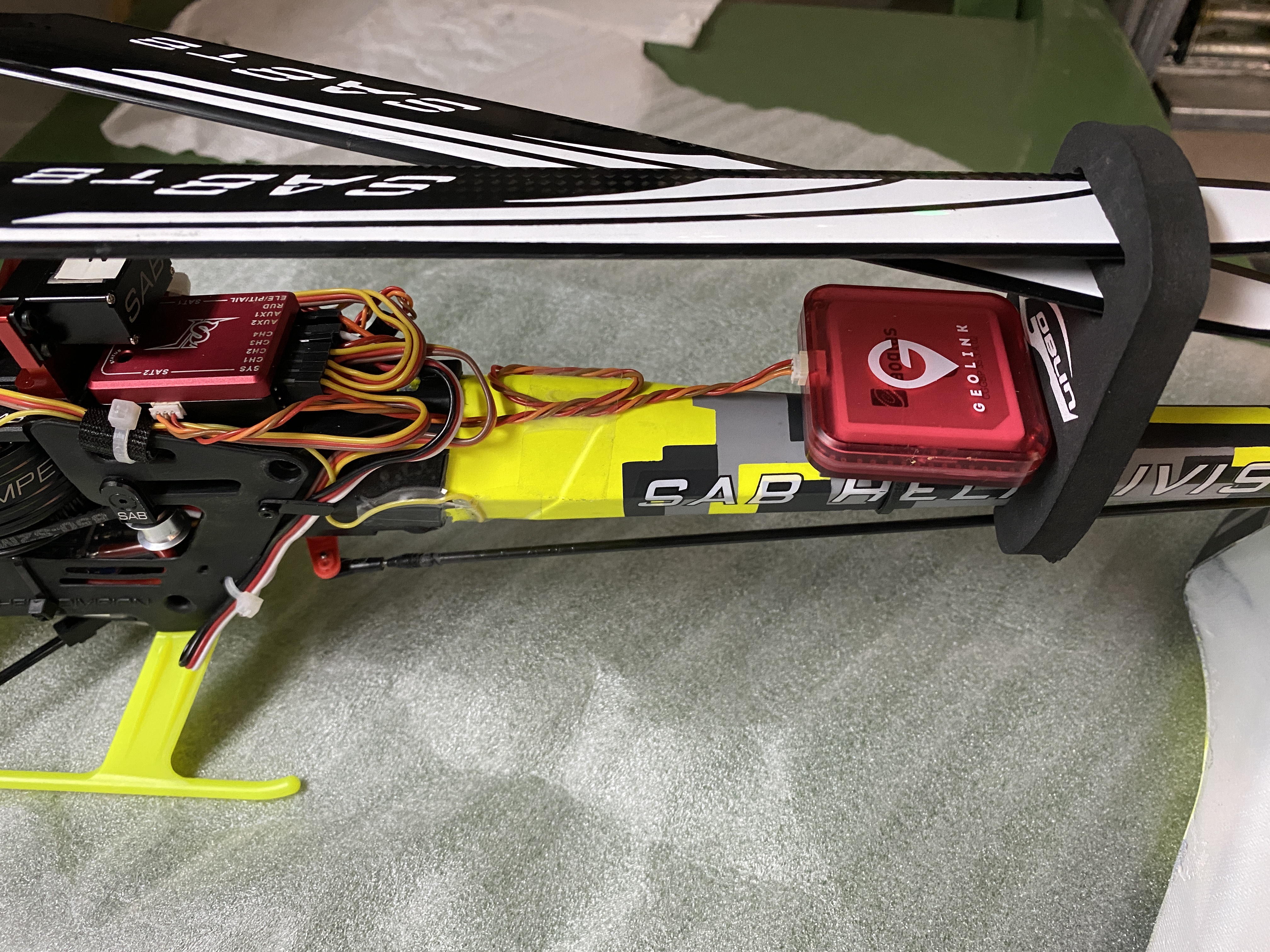

I am ading as well 2 pictures of the geolink placement with the Spirit Geolink bracket on the Fireball Havok. I did use the 3 functions and they have worked well during the flight... Just the message that makes me nervous..
