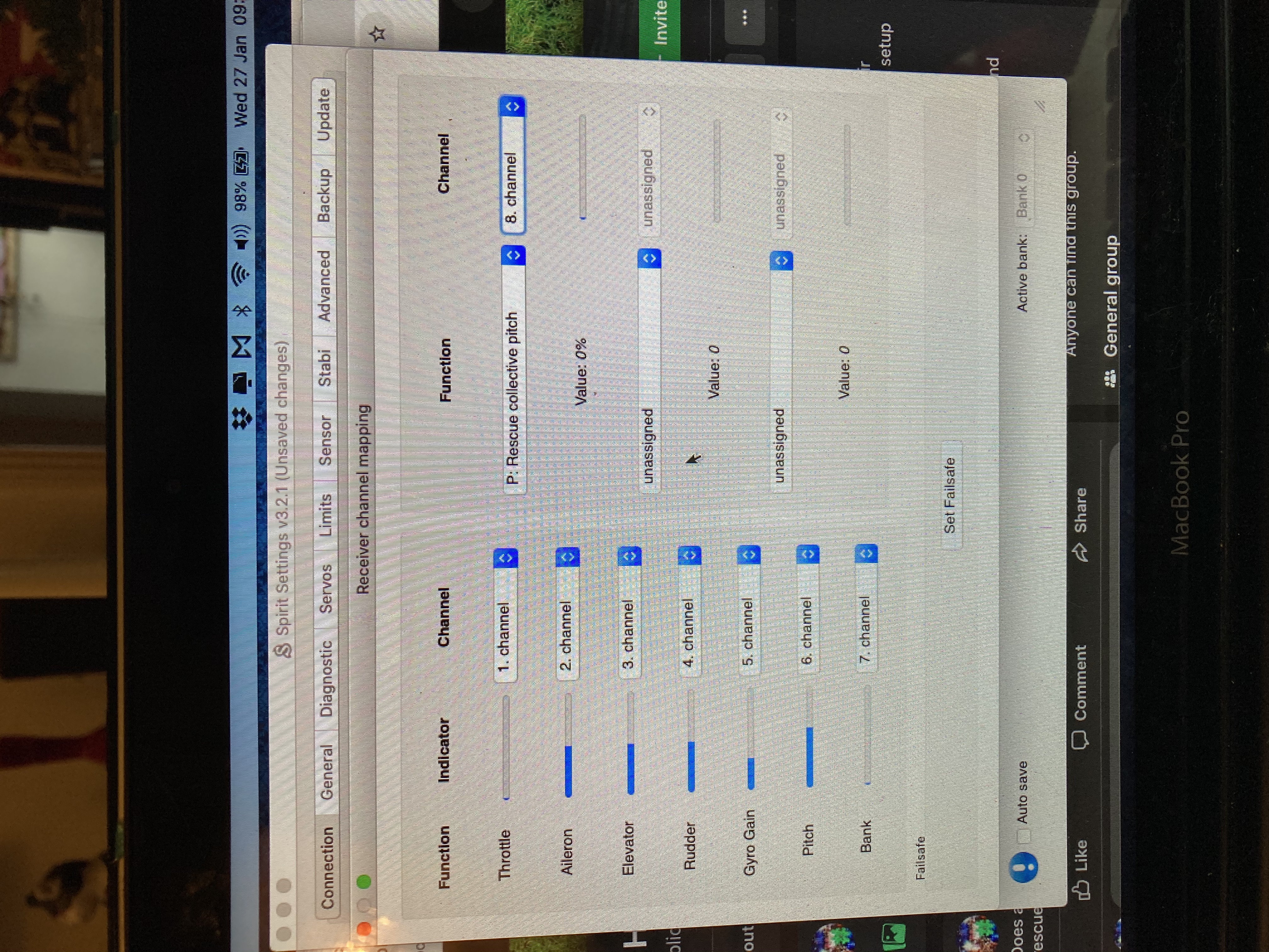

Is it possible to have Normal Stabi on one switch and Rescue on another without changing banks?
I've got a 10 channel TX (ORX TX10i)
at the moment i've got Normal Stabi via the Gyro and i've assigned Rescue to my channel 8.
It doesn't seem to activate the Rescue though.

its not possible,it is allways what you chose in stabi tab(for each bank) that is activated.
But why not use bankswitching?If you uses different RPM:s you can set different parameters
for each bank(RPM:s).
