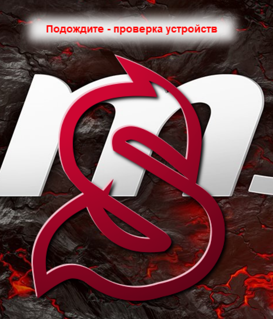

Hi, Can't connect to Spirit 2 through wifi link and windows 10 PC software. Everything work perfect on web interface. Done as per Wiki manual: demo mode, cntrl+W with updating IP - no result. Tried both: administrator and normal launch. Starting window is shown only without any progress.

Tried different ways: reinstallung, reflashing, brandmauer on/off, AP/AP+client, windows protection on/off, wifi link flashing with AP IP address/AP+client IP address - no result, still no connection.

Posts: 12836
please turn off bluetooth module in your notebook. Then it will work.
See this page:
http://manual.spirit-system.com/index.p ... es_message

Thanks for a kind advise - work now.
