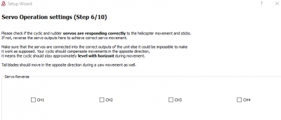

vvv850
Posts: 89
Joined: Mon 29. Jan 2018 10:52:34
Step 6 in the wizard will help you identify which servos need to be reversed.

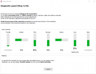

vvv850
Posts: 89
In this case, I think step 5 in the wizard can help you figure out the mappings.

The funny thing is that in the dianostic tab everything works as it should: the bar of the pitch moves up when we give pitch up with the collective stick and the elevator bar goes up when we apply nick forward and vice versa..... There is nothing wrong as far as I can see that. I checked with another heli of mine with a Spirit FBL.

I had exactly this same problem and could not work it out despite setting up 3 other spirit units and asked for help...Tomas suggested straight away about the reversal box in the servo screen and i then realised that i did not check that section. Ticked the box for front 2 servo's and that solved the problem.....
