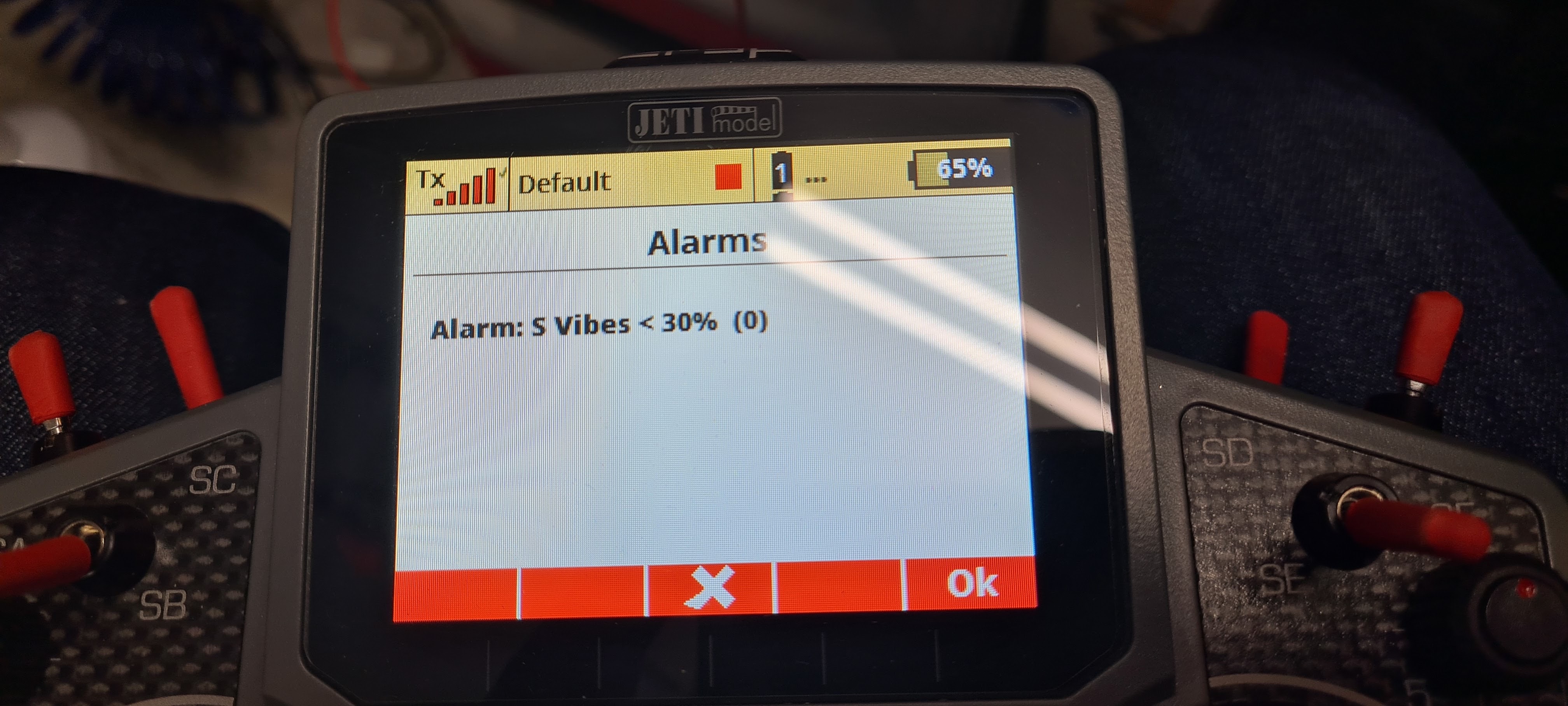

I got the screen with a alarm : Alarm : S vibes < 30% (0)
I have no clou what it means ?
Using a Spirit RS and DS12
Regards , Arno

This is an external telemetry sensor, from your FBL. The alarm means that the level of vibrations measured by Spirit went over 30%.
I don't know if this is a default alarm created automatically when using the Jeti wizard for Spirit, or you created the alarm in the past.

It may be a typo in the firmware but that alarm is saying vibes LESS than 30%. Look in the alarms section on the Tx and check what has been set. I would expect to see >30%. I set a number 10% more than my recorded vibes.

you can delete this alarm. It does not make a sense, because it will trigger whenever vibrations are under 30%. Likely you created it by mistake.
