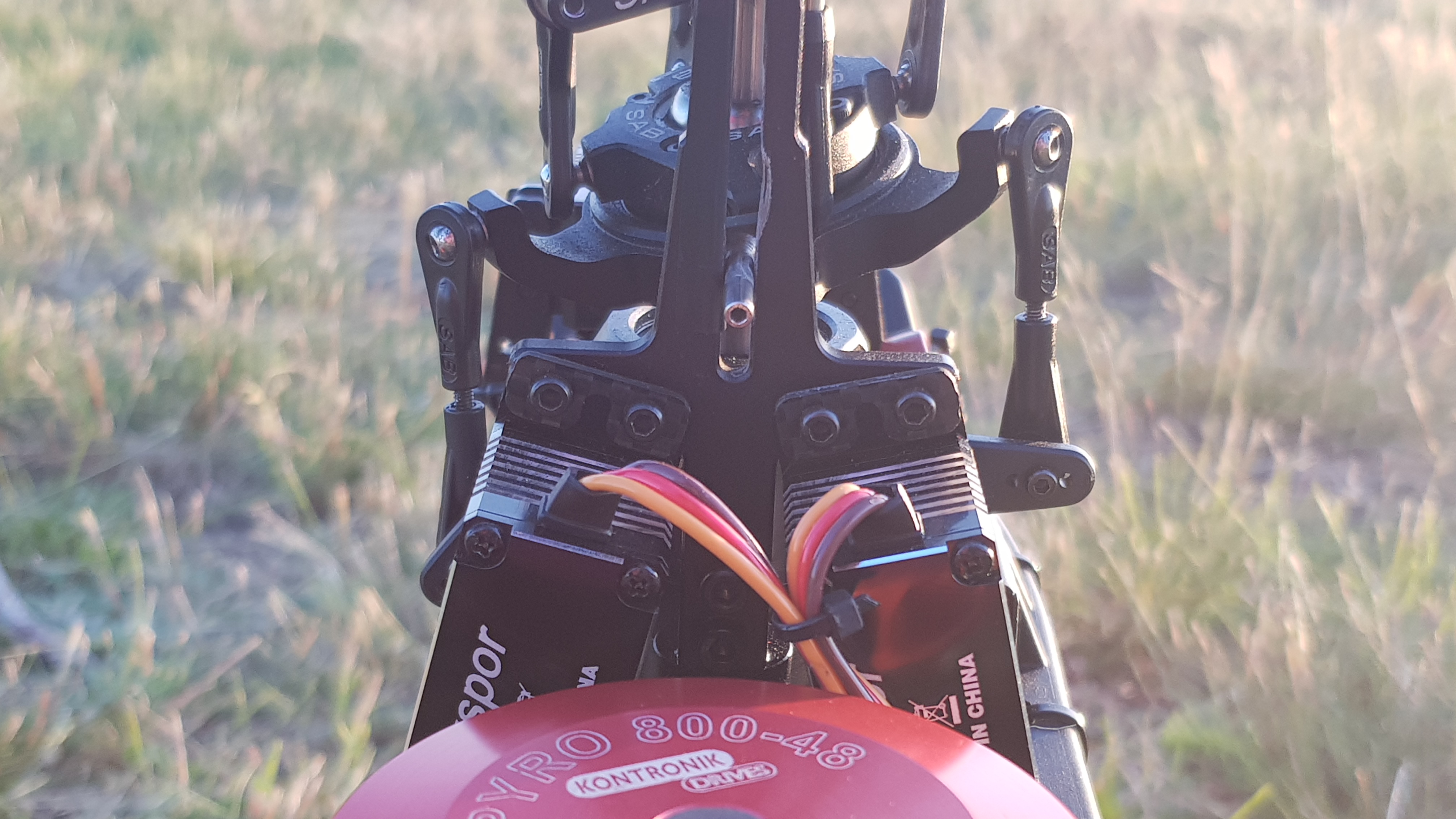

I have a problem, that Spirit sometimes does not initialize right, after update to 3.2.2. It makes a normal serwo twitch, and then - one second later - it twitches to the side and stays there. Always same angle. See photo. I wasn't able to make video yet...
