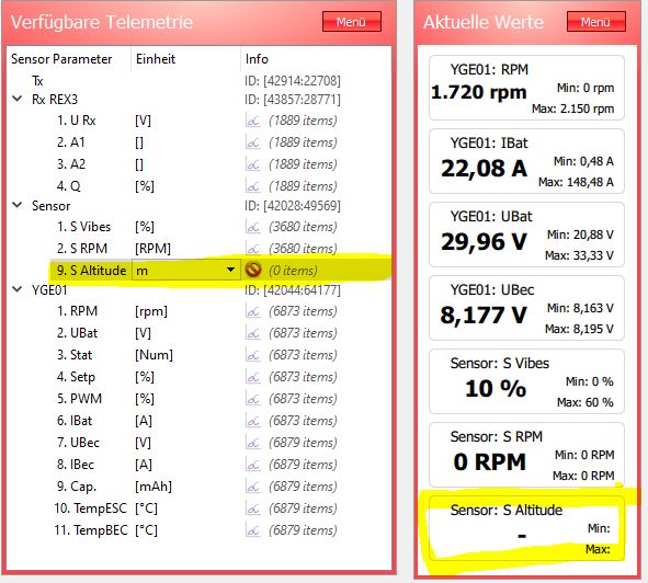

Yes, i made several flights since i installed the GT and have never seen any value in the Altitude field
In Jetistudio it looks like this: (see attached pic)
Posts: 13049
Thank you.
Please enable Spirit GeoLink in the General tab.
This requirement will be changed in future update.

It works now.
Tried the automatic rescue feature, too. Set the height to 20m.
Works also like expected.
