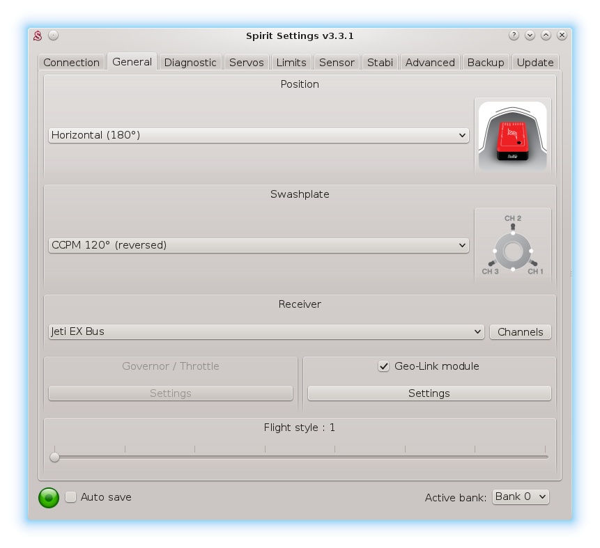

My answer: Please show me , because the point I cannot move it in the Software, on the GT with GeoLink.

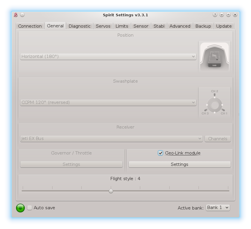

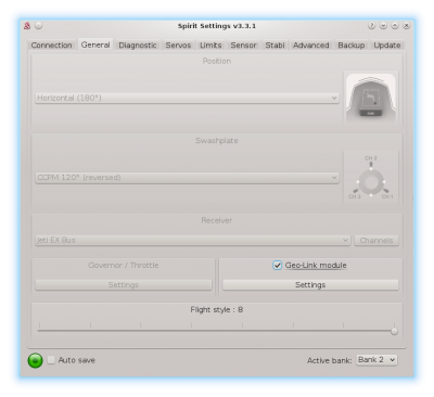

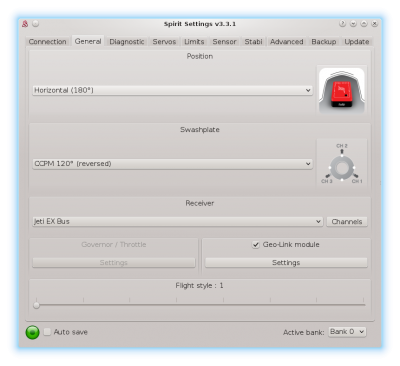

Here you can see my attachment. GeoLink enabled with Spirit GT and Flight Style is configured, even for 3 banks. I guess you assigned P: Flight Style in the Channels window but you forgot about it. Now it is always overwritten with channel value. It seems you are trying to configure too much things. It is important to understand first how each particular thing is working before configuring everything and then thinking it is bug.Please show me , because the point I cannot move it in the Software, on the GT with GeoLink.
It is important that in the Channels window you will see 2 or 3 mode for Return to Home. Function 2 is programming for all 3 banks, while function 3 is programming only single, selected bank.I already mention before that I see on the GeoLink Aid Tab switch ( Channel works) but on the GT no, and in case that the channel value is not good, why I see it on the software working when I switch in the Transmitter. Why you not up to date a little bit the Manual, even the Port using on the GT for the GeoLink is not stated there.
My answer: Now it works ??
