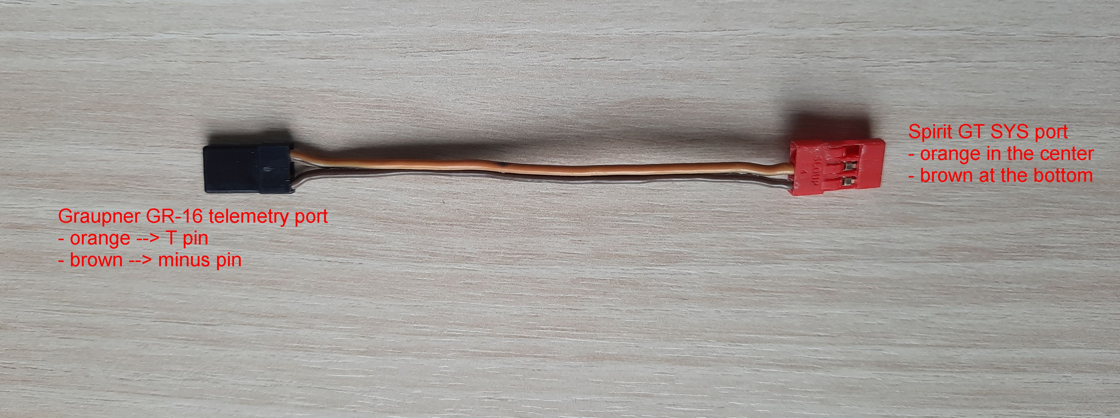

- I have made the correct cable and measured that it is OK (see picture attached) but I can't get my radio to see the Spirit GT.

I can't find anything wrong in your setup or cable.
When we are trying it, it just works.
Sometime the only problem is that in your radio you have to select General module for telemetry.
SUMD connection is working normally, right?
Can you take a photo of the wiring?
Your unit is certainly OK.

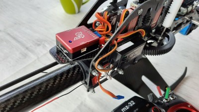

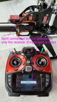

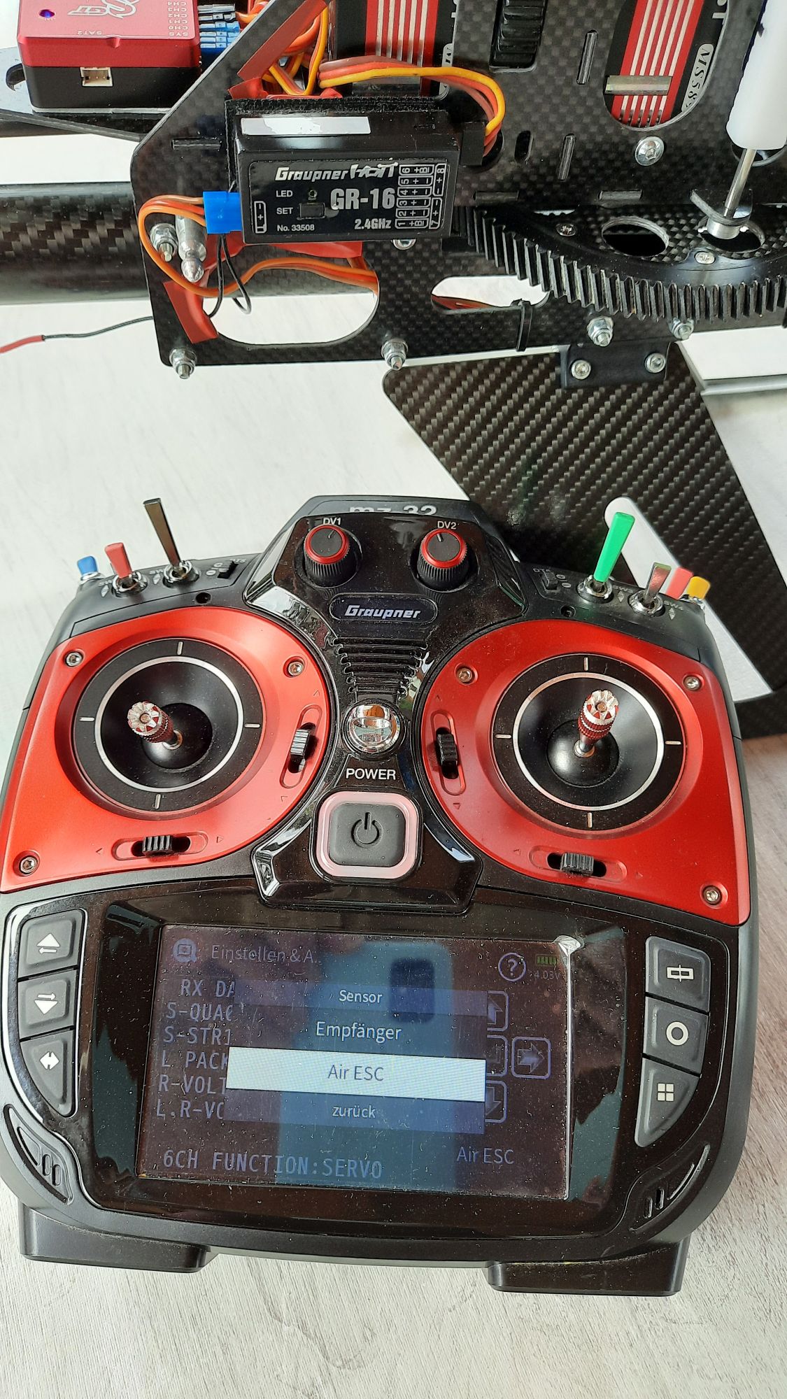

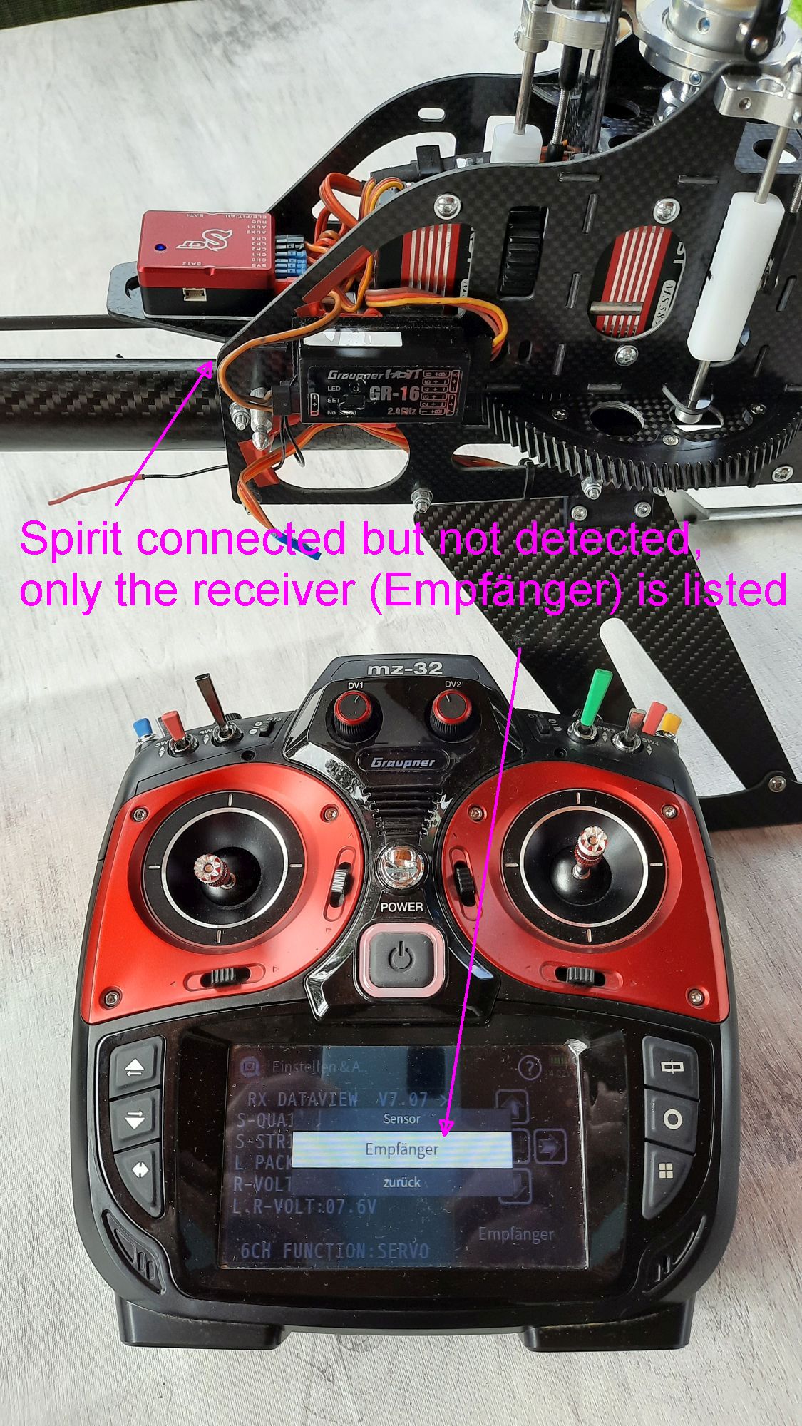

thanks for your feedback. I have attached some picture of my wiring.
- When the telemetry cable is connected the General device is not detected by the radio and therefore I cannot select it.
- I have noticed that the Spirit GT does not initialize properly when the telemetry cable is connected to it and to the tele port of the GR-16. The blue LED on the Spirit blinks for a short moment and then it turns off. Sometimes the unit initializes OK but most of the time not.
- I suspect that the Spirit does have a problem after all. Either it had it from the beginning or I did someting to it it did not like, which would surprize me as I took extra care, knowing that the two outer connectors of Spirit Systems must not get power (not my first Spirit System).

Not sure whether I understand your request to try it without the ESC connected. Currently the ESC is only connected to the receiver when the Spirit is not connected to it.
To be clear. It is either the Spirit GT or the ESC that is connected. Since the Spirit telemetry is not working I'm flying the Heli without the Spirit telemetry cable being connected but I then connect the ESC directly to the receiveer so that I get its telemetry data.
I do have a special cable to connect the ESC to the primary SAT port, but as long as the Spirit is not communicating with the receiver there is no point in keeping this connection between the ESC and the SAT port.
