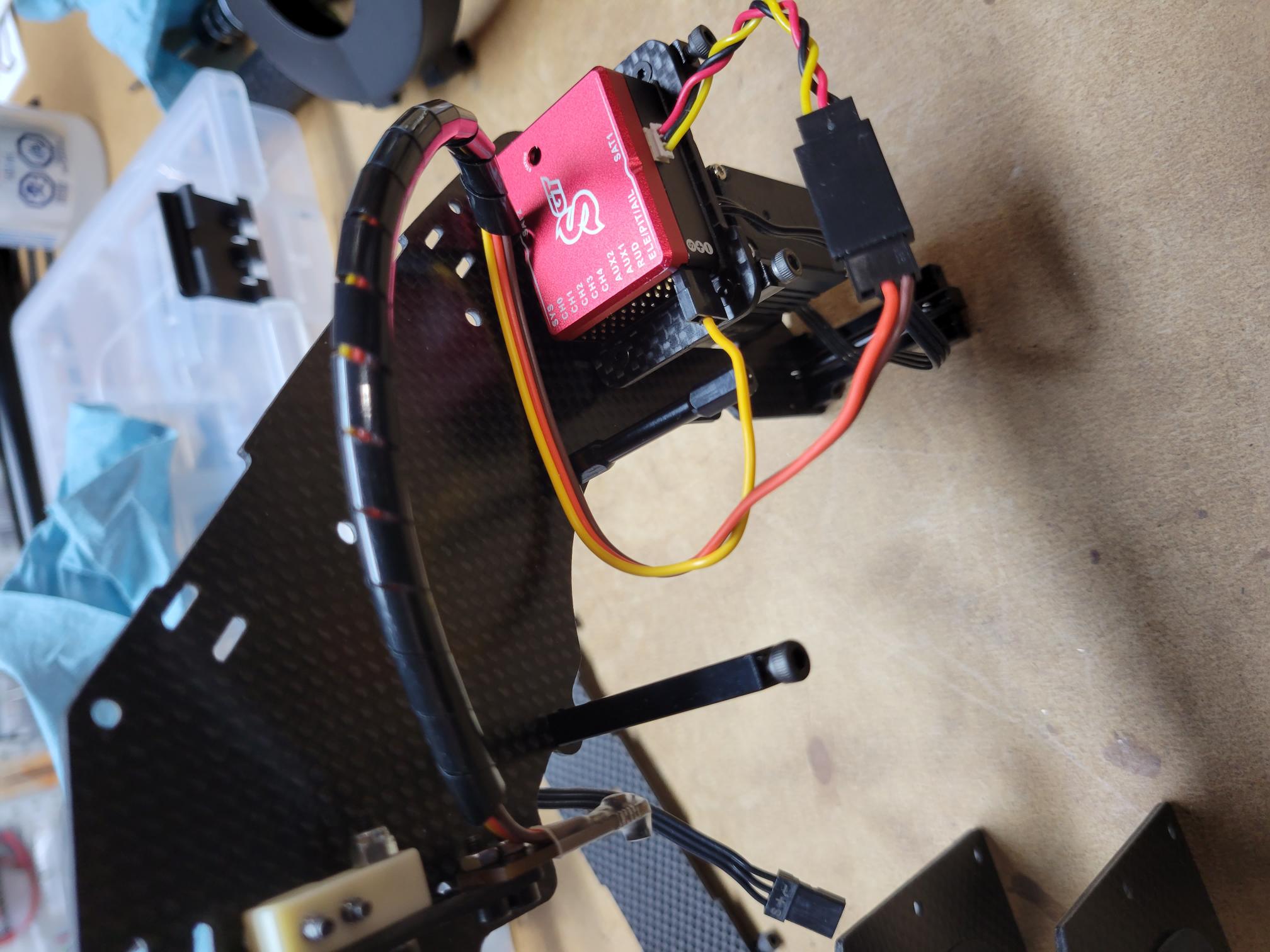

setting up a new Tron nitro heli with my GT unit.
Tomas, can you verify my sensor hookup? going to get this together and flying in a day or so.
Thanks in advance.
Posts: 12930
looks good! What sensor it is?

Posts: 12930
Unfortunately we have no experience with the sensor, but the most should work well.
Please note, in our manual we recommend that both magnets have same polarity.
So in the worst case, if it will not read well, you can try to swap it.
In your configuration Sensor Divider should be set to 1. With both facing at the same side there will be 2.
