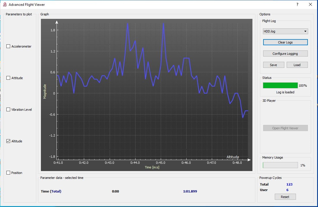

I came back home and looked at my flight logs and was surprised to see that my altitude values looked totally erratic. My log was sampled at 10Hz, you can clearly see that logging did occur 10 times per second but the altitude data looks wrong to me. Throughout the entire flight log the altitude was increasing and decreasing. I have zoomed in to a portion of the graph to show what is happening.
Looking at my logs it looks to me like the altitude sensor data is not reliable.
Do I have a problem with my Geolink unit or have I made an error configuring something?
Is it possible that the pressure sensor in the Spirit GT is "fighting" against the height sensor in the Geolink?
Please find attached my Bank files and an image showing the altitude log.

If GeoLink is used then sensor from Spirit GT is used.
If your model will change collective pitch it will change pressure near the GeoLink and cause change in altitude.
The problem is likely not wrong sensor. But in the most cases it is due to collective pitch center.
Please try to enable Subtrim (tuning) in the Servos tab.
Then verify if swashplate is levelled and there is 0° between main blades.
