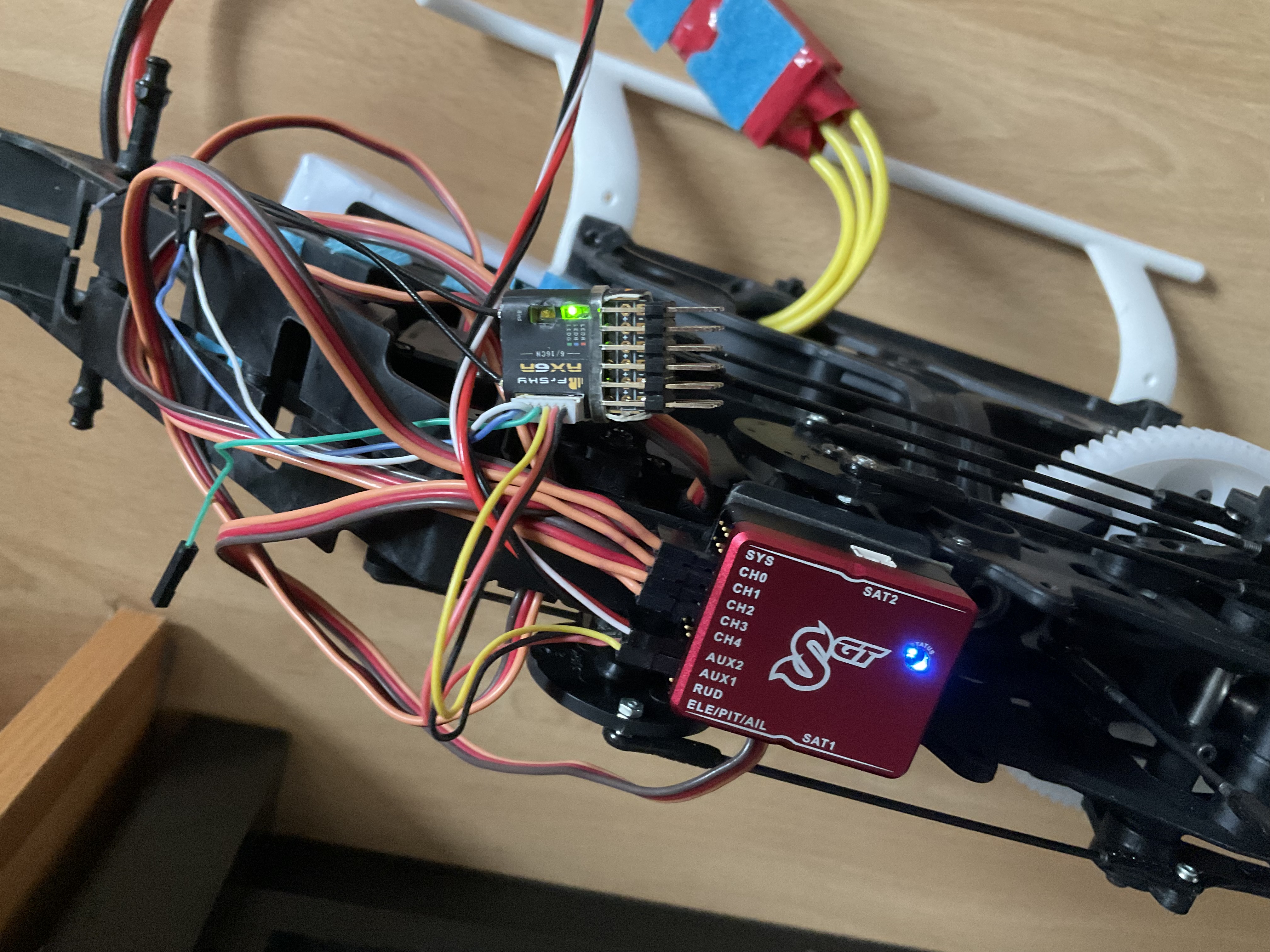

last night i tried to connect RX6R with Spirit GT. No succes, only pwm Futaba R617Fs works.
My frsky equpiment: Horus X10S isrm Modul, RX6R firmware 2.1.7 access. By many trys, only onetime i had a connection to my horus tx. It`s possible i have killed the port?
Or can i try RX6R accst with futaba sbus.
i don`t know what to do

Now Spirit GT working with S.bus and S.port correctly.
F.port not working. I have changed RX6R under option F.port, GT to Frsky F.port. What can i do?

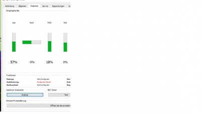

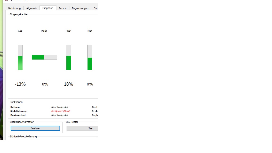

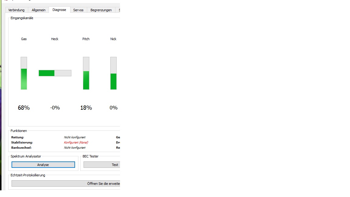

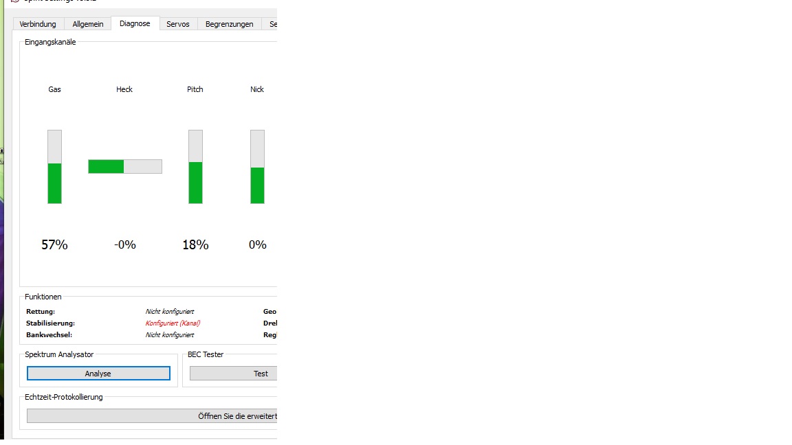

Hallo
I have still a little blemish. GT connected by F-Port.
Frshy X10S channel 3 programmed - 100%, 16% and 35%.
Spirit shows - 13%, 57% and 68%?
