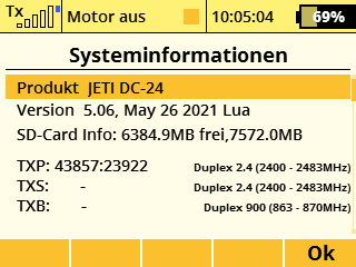

Hello
what software version is on your transmitter?

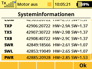

Some details would help
What tx are you using?
Which Spirit model?
dit71
Posts: 23
Joined: Thu 18. Jan 2018 20:54:15
I'm sorry about that.
It's a brandnew spirit GTR Ver. 3.3.3
Dieter

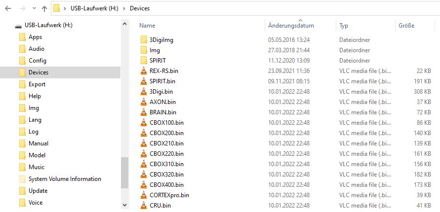

The bin directory:
Posts: 1068
download to PC, unzip and then copy to transmitter to Devices directory (overwrite old files)
https://spirit-system.com/dl/jeti/SPIRIT-3-3-3.zip
and then : http://manual.spirit-system.com/index.p ... reparation
