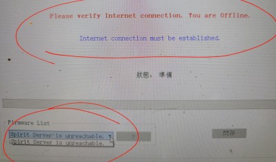

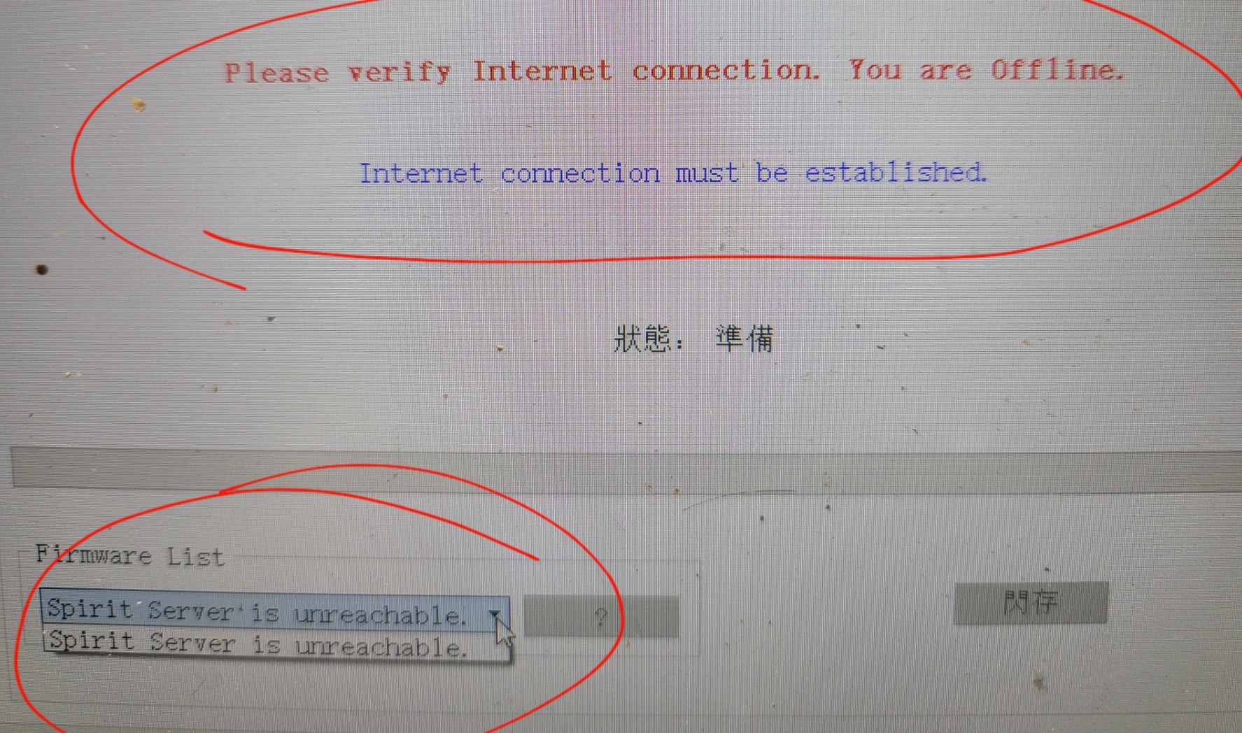

Close the network connection. The gyro setting software can run and no longer crashes. But if there is a hint like the photo, will it affect the validity and reliability of the software's settings for the gyroscope?

swash23
Posts: 40
Joined: Fri 01. Nov 2019 13:32:19
Location: Munich, Germany
you can still make all settings to the FBL system. Only new firmware versions will not be displayed.
