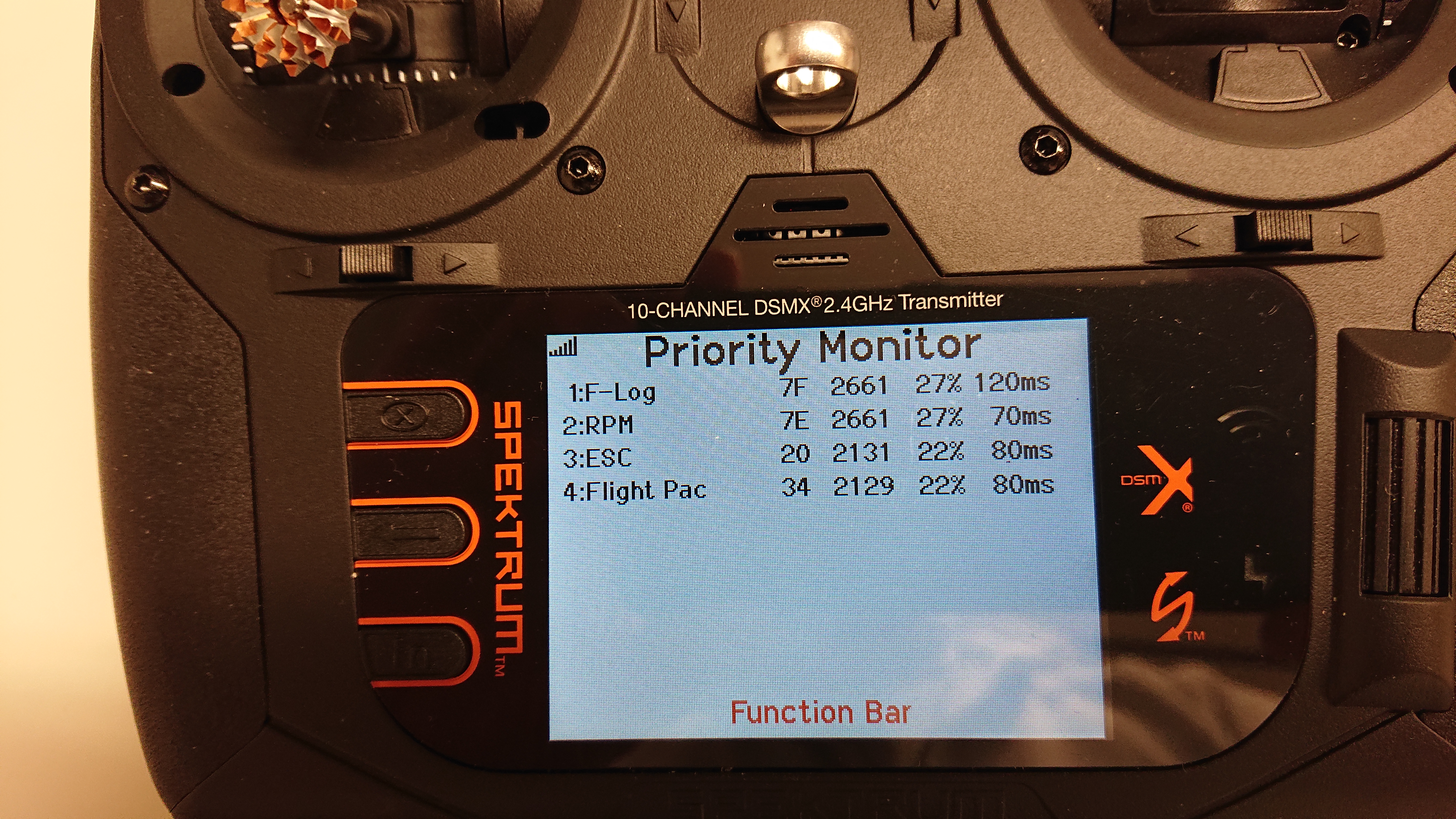

Hello Tomas !
The NX10 respectively the NX Series have an Priority Monitor - here you can see what telemetry data are available - I have made an screenshot from my NX10 - Here you see the available telemetry and here you see no TextGen - Why do I say this ? I have seen an video in youtube from Airmarshall who has presented the NX Telemetry - In his priority monitor I have seen under point 5 TextGen ?!! One module of his modellsetup has sent TextGen !
I think that's here the problem, because I have tried this with the Rudder- and Aileron Stick and nothing happens -
I have already described this above -
Yes, I understand, that you won't buy hundred of radios, but you must see that this people will buy your FBL-System and I think there are some enough to justify a buy of an NX.. maybe you have some contacts to lend out an NX to test ? This will be very helpful -
