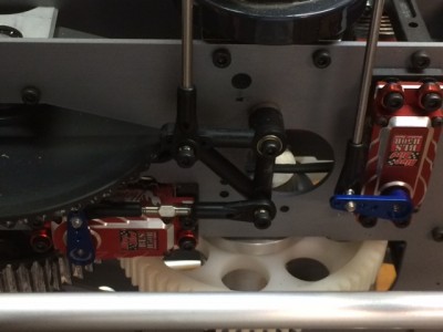

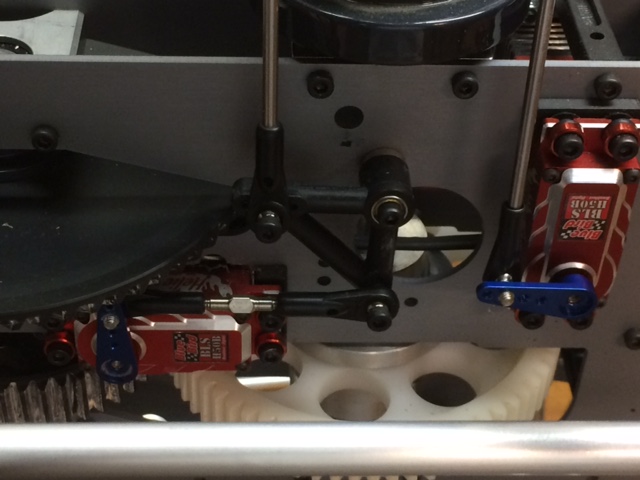

hello All ! I am redoing a Vario Lama , It have a 4 servos set up , It had BD 3sx but of course that has to go , make room for Spirit Pro . I select the CCPM 90 ( Velos ) everything work except the 2 elevator servos, if the pitch stick move all servos move in the same direction ( good )if the elevator stick move the 2 elevators will move in the opposite the direction and if I reverse the servo direction on 1 servo the elevators will be fine but the pitch will have 1 servo move in the wrong direction .
Is the CCPM 90 (Velos ) is right for the set up since the picture shows the elevators are 1 in front and 1 in back but my has 2 elevators in back .Also when Ail stick move only 2 front servos move instead of 2 on 1 side move . I needs some in put .... here is the picture of my servos set up on 1 side , the other is just the reverse of the one on the picture . Thanks in advance . :?: Actually it should works like a tandem without the rudder movement . Tomas ! can you please help ? Please

your settings should be correct. But you will need to change Phase of the swashplate by 45°.
On the other hand I dont understand your mechanics fully. Tandem is working differently, it has two swashplates.
