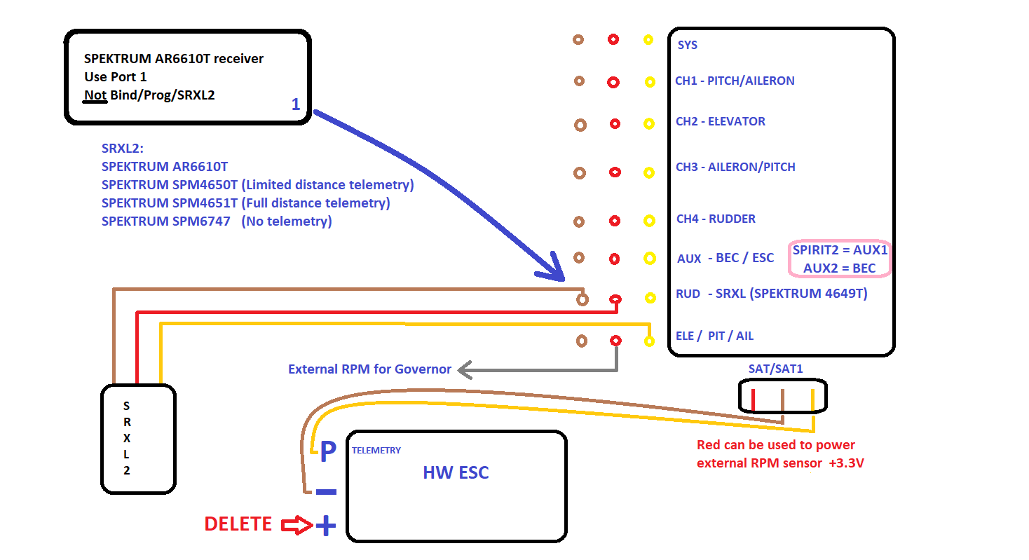

I noticed in the online manual SRXL wiring the author are using a SPM4649T receiver: http://manual.spirit-system.com/index.p ... e=SPM4649T
The SPM4649T is an SRXL receiver (not SRXL2); however, the wiring example supplied are connecting SRXL2.
Using the SMP4649T as an example is a mistake in the online manual.
Correct SRXL wiring: http://manual.spirit-system.com/index.p ... D_RECEIVER

Quick wiring SRXl/SRXL2/Hobbywing
Correct SRXL wiring - all pins in RUD
Example of SRXL2 wiring with an SRXL receiver used

So that we are on the same page...
- I noticed Thomas asked where I found it was SRXL2. I stated SRXL, not SRXL2
- Does this mean that the 4649T are being connected to a Spirit FBL like an SRXL2? So the manual are correct?
- Lastly, the 4649T will transmit telemetry - battery voltage, RPM and everything else as needed?
Hope to hear from you guys :)
Posts: 13049
Yes, manual is correct. Wiring is basically same as for SRXL2, but not identical. Different cables are needed as described in the guide.
If your ESC has telemetry support, then yes. All telemetry data are then transmitted to your radio.
