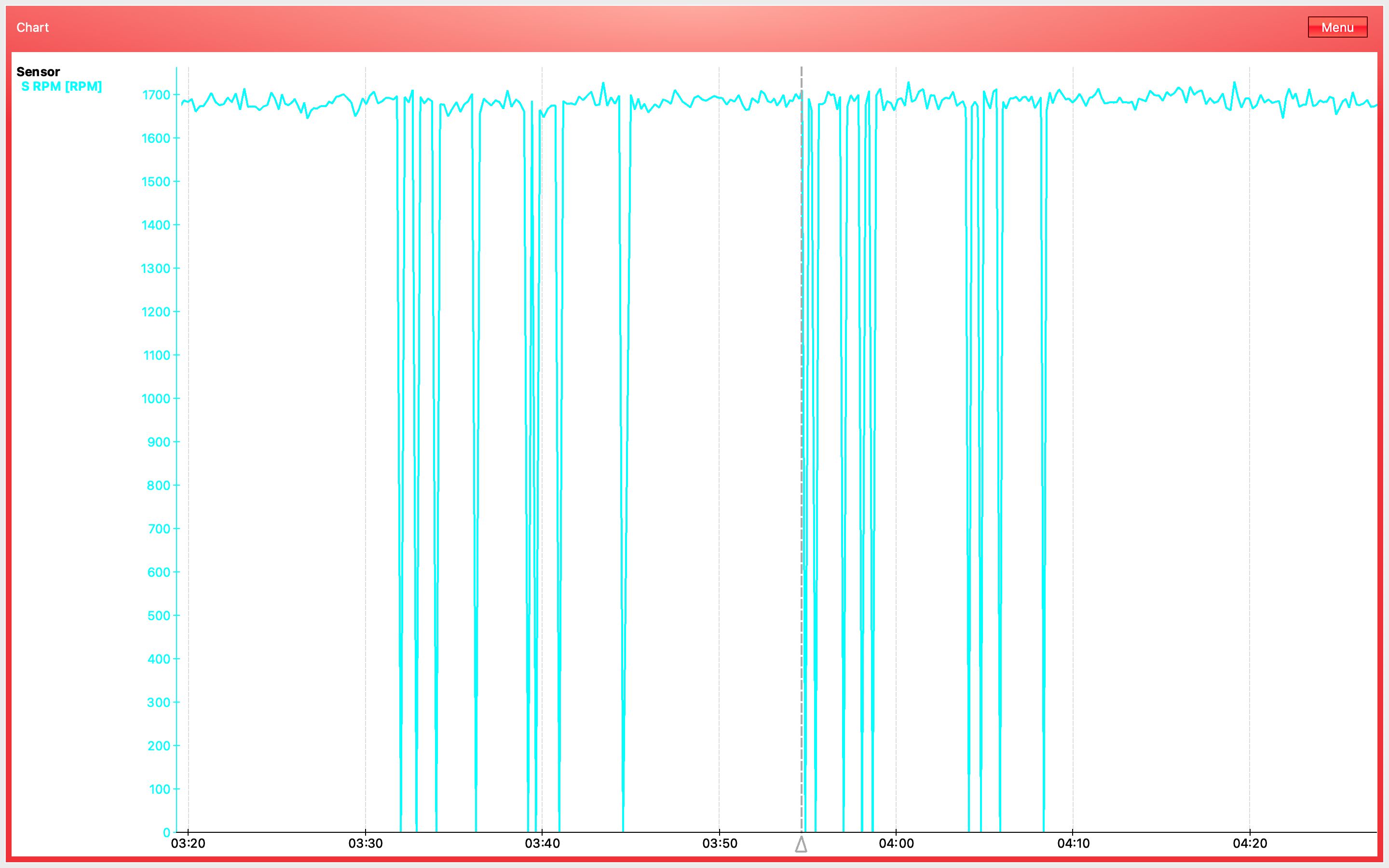

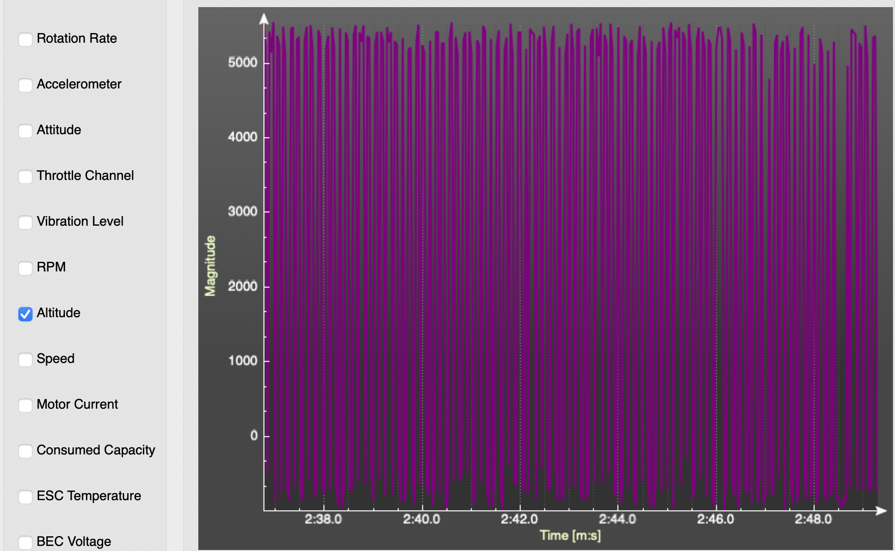

I am having a problem with logging and RPM telemetry with a new Spirit GTR in a new XL700 Specter VB1 build. In my Jeti DS-12, I get all the correct telemetry except for random dropouts of the RPM telemetry. I have attached a portion of the Jeti RPM log. All of the advanced logging in the Spirit unit seems to be corrupted. The telemetry is all over the place. I have attached a screenshot of the altitude log. The other logs are similar. The telemetry being sent to the Jeti seems to be correct. There is accurate altitude data (and other channels) in the Jeti log.

Altitude
Altitude
Jeti RPM log Flight1

I reset the logging to only log Altitude then cleared all the logs. Attached is both the FBL and TX log. It is more readable but goes from -1000 to 5000 units.

it looks like your unit could have some issue with the pressure sensor. If your other unit does not have this issue then I am afraid the easiest will be to replace it. We can send you new unit.
Readings must be always perfectly stable, at least of this variable.
