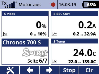

Helllo,
as soon as the motor is running the telemetry values of the Kosmik 160HV are going crazy as you can see in the screenshot. I use an extended telemetry cable from the Kosmik telemetry port to the Spirit GTR, and if the motor isn't running everything works fine, but as soon as I start the motor the values are very strange and a max BEC current of 33A and a Temperature of the Kosmik from 139°C cann't be true, because the heli is running for a few seconds without the blades and I didn't touch any stick.

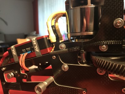

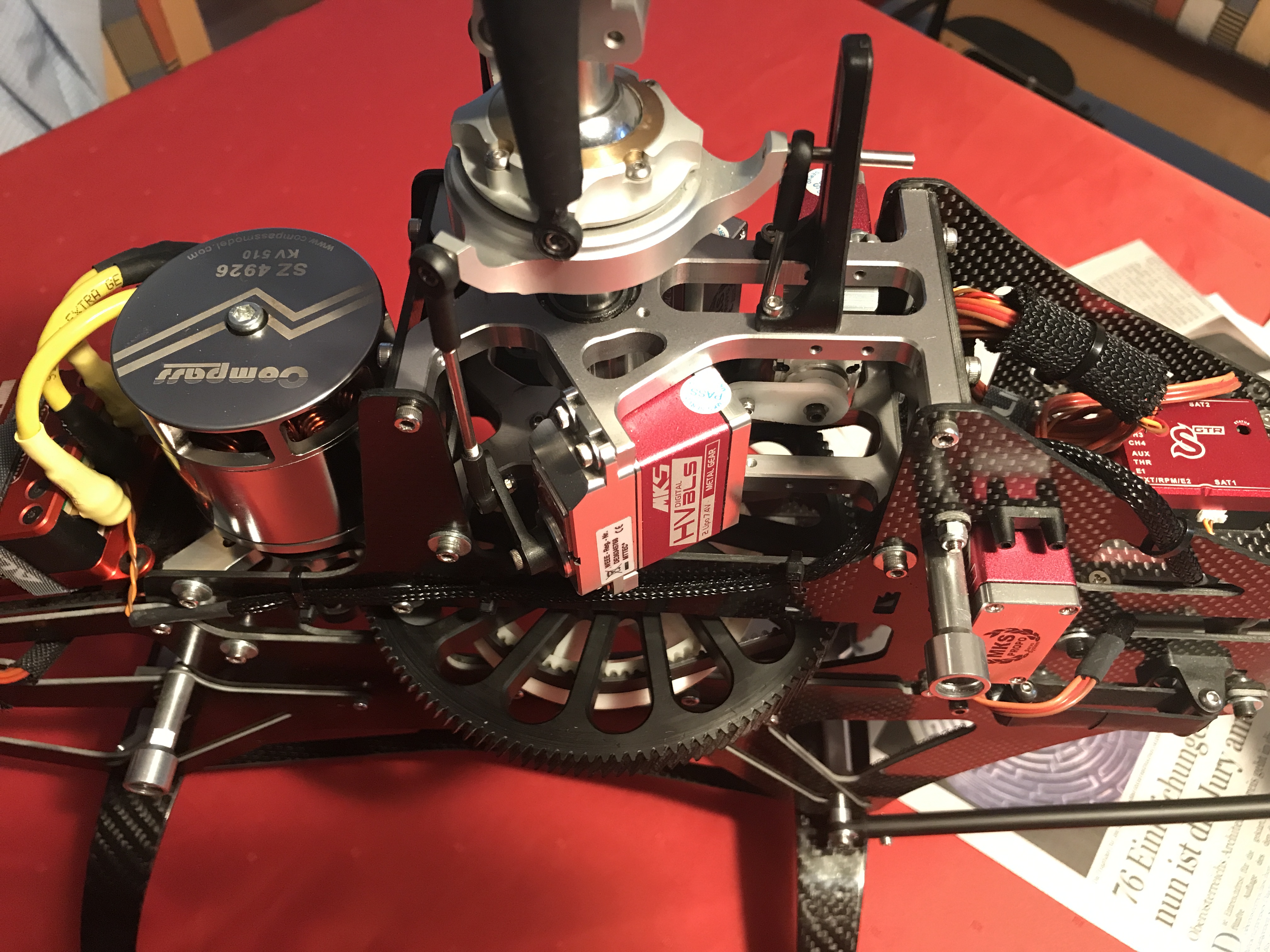

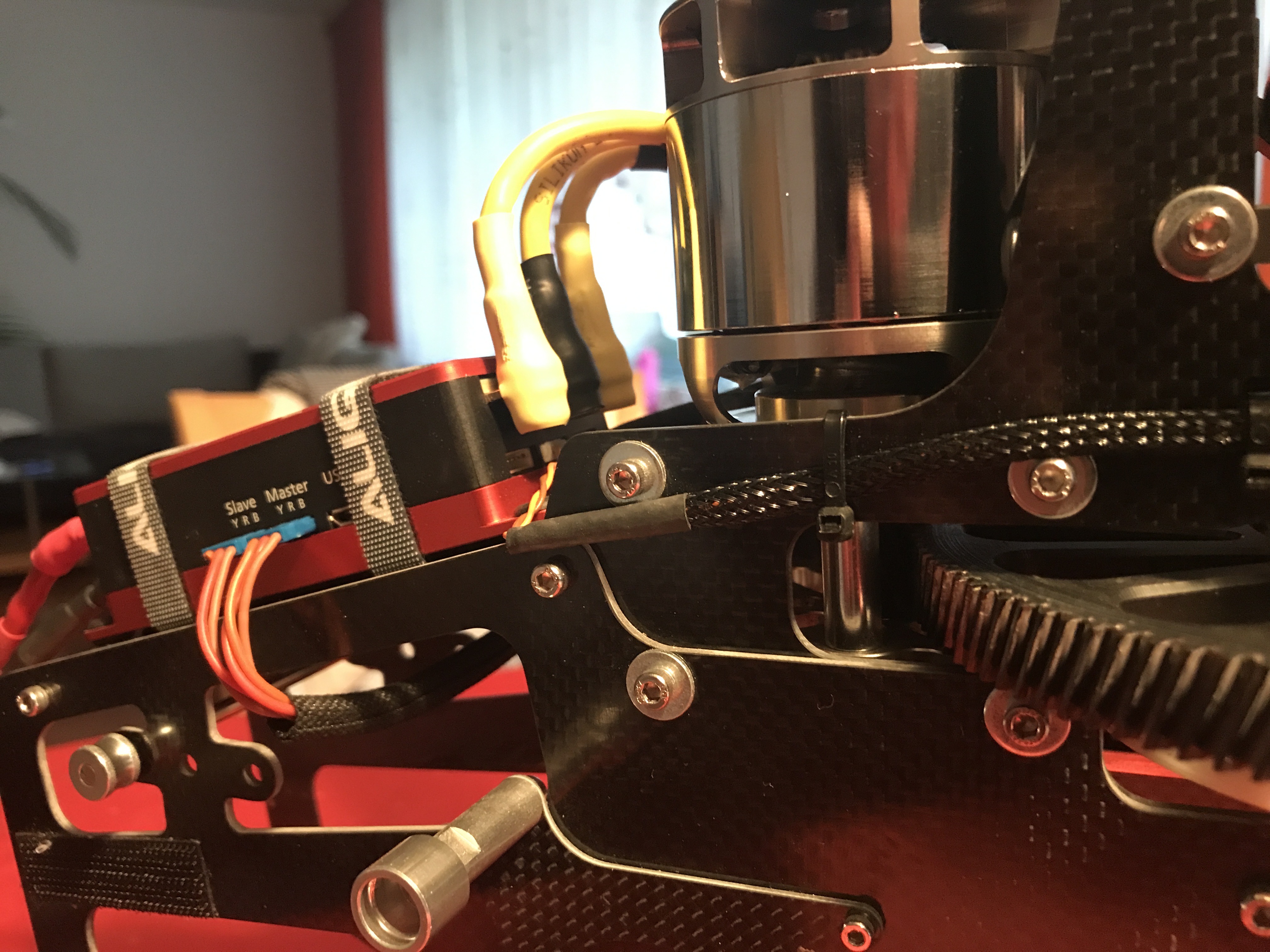

It is the latest Firmware (4.17) on the ESC and it is wired far away from everything, as you can see at the pictures. The cable is okay, otherwise I wouldn‘t get any telemetry value.
