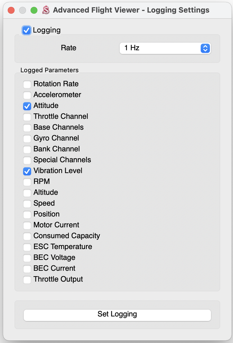

should be the "Advanced Flight Viewer" in the Diagnostic page of Spirit Settings.
ofc before to get any log, you have to configure what variables you want to log and how often
using the "Configure Logging" button

My problem was when I opened the "Advanced Flight Viewer" the window was so large it went "off screen" and completely cut off the right hand section where all the dropdowns and buttons were.....somehow I never even picked this up :oops:
Any case I am happy I can see my logs now!
