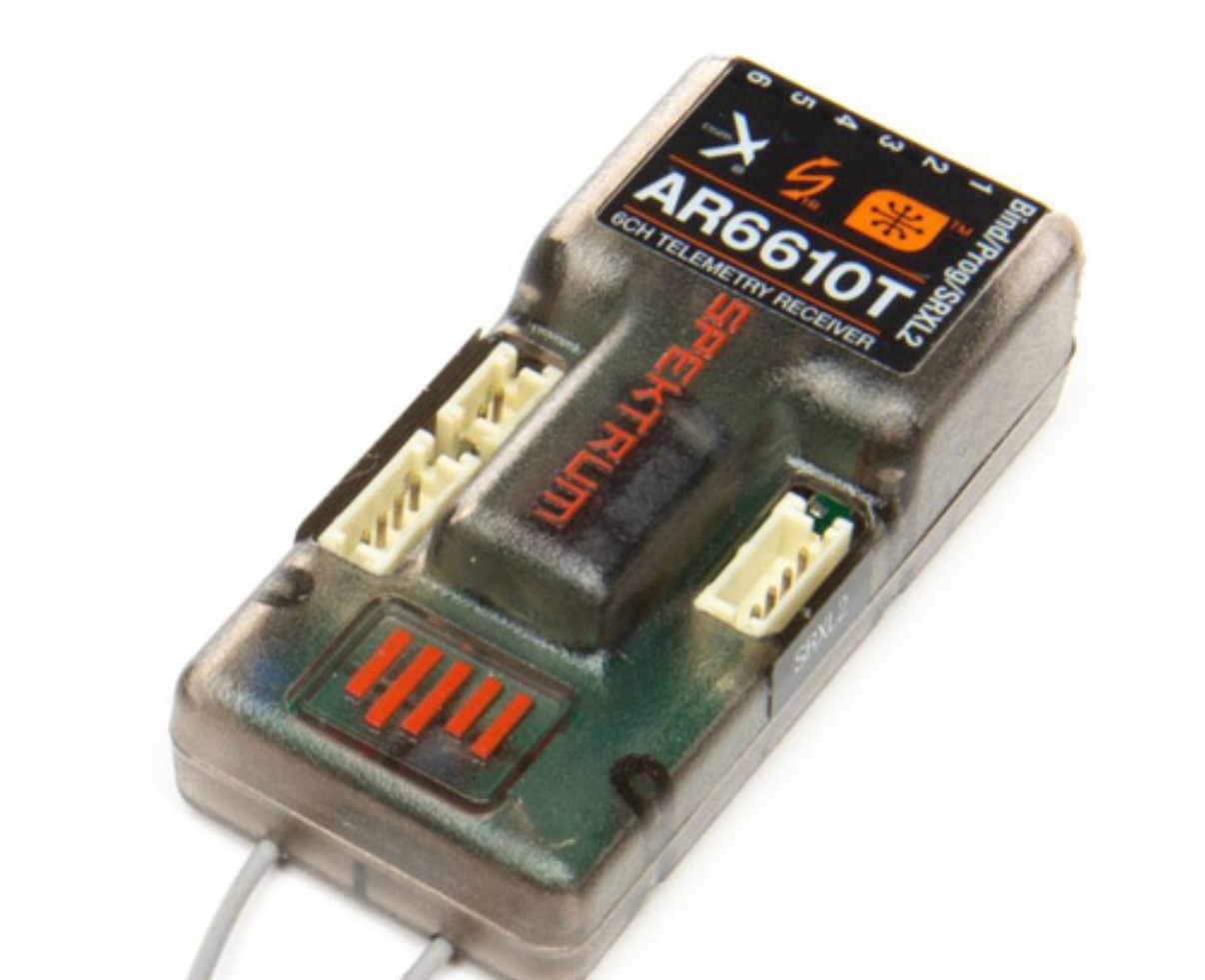

Ok so now I have the spektrum AR6610 T with a 4651t sat
I have them both bound to my DX9 .
problem now is that if i take out the signal on the 6610 then the sat does not take over, nor is my TX showing any telemetry from the sat
Am i right to think i need to flash new firmware 3.3.4
I cannot see it in my update page , it goes only to 3.3.3
thanks
Neils
Posts: 643
Hello Neils,
is the 4651T pluged in the port of the AR6610 T or have you pluged in the sat2 port of the of the Spirit ? In this case you should only plug in the port of the AR6610 T - the cable from the AR6610 T to the Spirit should pluged in Port 1 to the Ail-port and Rud Port in the Spirit - Then all should work ! You have no redundancy because o powersourcing of the satellite when the AR6610T gets no power -
neils
Posts: 12
Joined: Sun 20. Feb 2022 19:39:11
Hello
Thanks for your reply
Yes I have the 6610 plugged into the flybarless and the 4651 sat plugged into the 6610, both bound to DX9
I take out only the signal orange cable leaving power on for the 6610 , the sat 4651 is not taking over, also MY TX does not see the satellite 4651.
If I use an independant power source to the 6610 with sat plugged into it , My TX is able to see Both the 6610 and the 4651
thanks
Neils
Posts: 643
