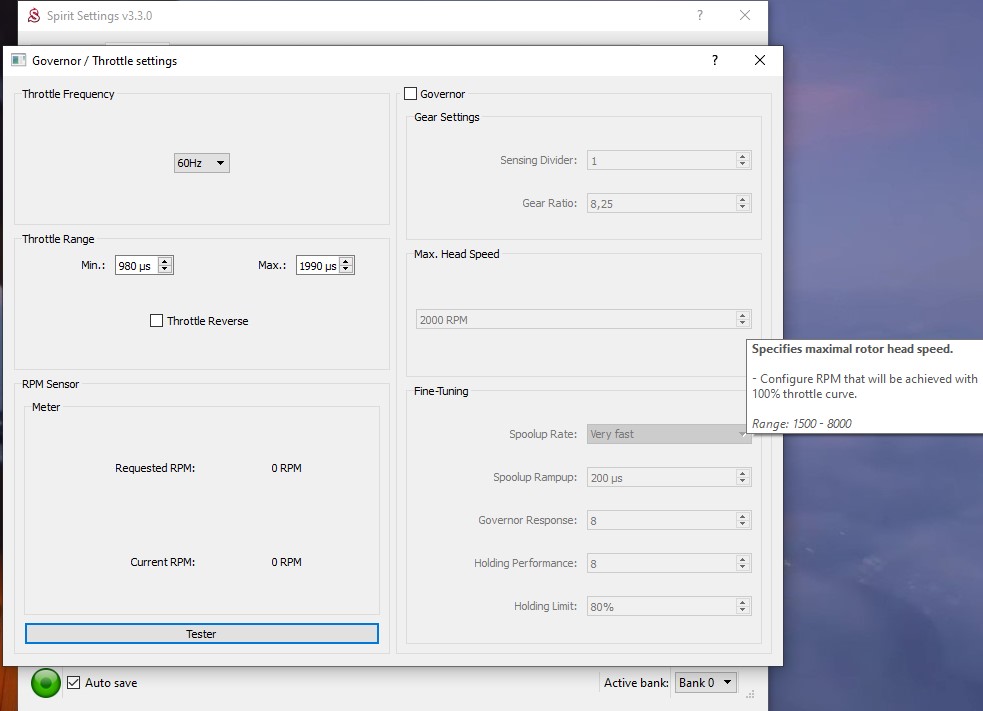

In the picture is my Governor settings, although disabled for now. I hovered the cursor on the Max Head speed line, hence the explanation box. The Throttle frequency was originally at 200Hz, adjusted down to 60Hz for the test previously mentioned.
Is the RPM value set in that box ment to be the "Actual" max head speed that the helicopter can achieve with 100% throttle curve?
Or can I set it at whatever I want (within reason of course) to make it "easier" calculating the desired head speed? Like with 2000 RPM, a 90% throttle curve would give 1800 RPM.
Not sure if I have understood that correctly...
Cheers.

Posts: 12997
each sensor is very different and could make very big difference regarding performance.
Each is also used for different mounting. They are also designed by different manufacturers and were originally intended not to be used with other controllers.
With Spirit most sensors will work, but some can work better. For example using hall based sensor and magnets should work well.
