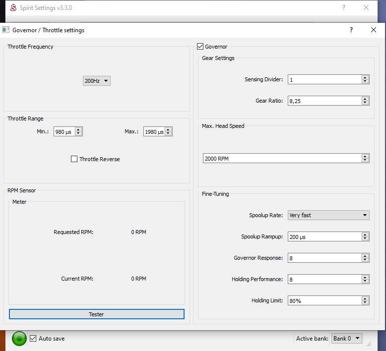

I looked at the log with the RPM and Throttle output, and there is something weird. The throttle output curve is very flat and "unresponsive", so I don't know what is causing this?
In the Governor/Throttle settings the requested rpm are 1700 in Idle1 and 1900 in Idle2.
The logging rate is set to 50Hz.
If anyone could shed some light over what I am doing wrong, or what the GT is doing wrong it would be very much appreciated! :)
I attach a screenshot of the Advanced Flight Viewer and the Governor/Throttle settings.
The red colour is Throttle output and the green is RPM.
If you need anything else just let me know.

if you are unsure if Governor is working, please check Flight Log where you should see Governor was Engaged event.
Please make sure to engage Governor directly from idle RPM. This could help to resolve the problem.
I do not recommend to use that gain high values for Governor. Instead please start with 3 and 2 for example.
Can you tell me what sensor do you use and how is it connected?

Second fault, also my own, is that I never used the "Tester" in the Spirit Governor/throttle settings until today. And that showed a sensor that was Active the whole time EXCEPT when passing over the magnet.
Surely that must have messed with things...
So I just ordered a Spirit RPM sensor. Hopefully that will be better 8-)
Usually I take off in Normal mode and then switch to IdleUp when in hover/flight, but I will try as suggested.
I will also adjust the gain down, no wonder I had to increase them with a faulty sensor...

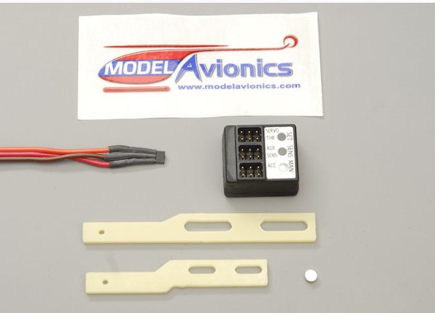

I have used the sensor that came with the ThrottleJockey Revmax from Model Avionics, it's a hall sensor but that doesn't mean it's working correct for the Spirit governor.
See the picture below. My neighbor tried searching for info on it, but there was nothing to be found.
EDIT: the connection is Brown and Red wire (from the bottom up) on CH0, and Orange wire to mid pin on ELE/PIT/AIL.
