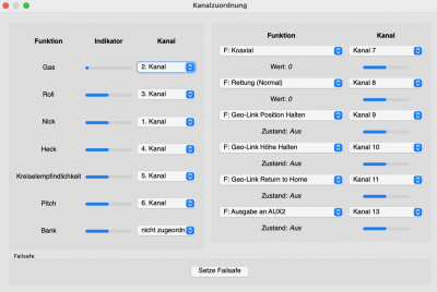

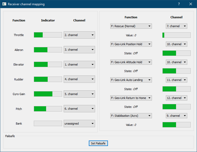

On the channels dialog, there's only 6 available entries for functions to be set. Please increase this to 10.
At the moment, i'm using 4 for GeoLink, and 1 for rescue, and I use the last one for tuning.
With the release of spirit v3.4.0 firmware, it's possible to set stabilisation using functions, however there are not enough free F: slots to be of any use to me, which is a real shame as i'd like to enable rescue and stabilised flight modes from switches.
My radio has 16 channels (opentx/edgetx), I use 6 channels for control (T,A,E,R, gain, pitch), and would like to use the other 10 channels for functions.

Can I please ask for this again. You've added loads of new features to geolink and I can't use them because the software doesn't support more than 6 channels for functions.
I'd like to set up the following:
Switch 1
Rescue (acro)
Switch 2
Geo-fence + Alt limit
Switch 3
Alt hold + position hold
Switch 4
Stabilisation normal
Switch 5 (3-pos switch)
Return to Home (mid sw position)
Auto-landing (high sw position)
To do that, i'd need 8 function channels, the software only allows 6.
