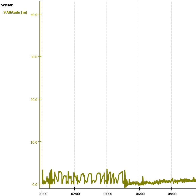

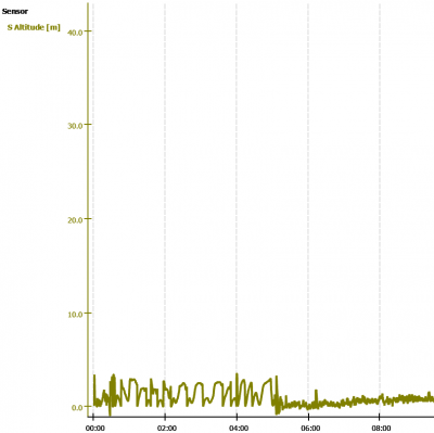

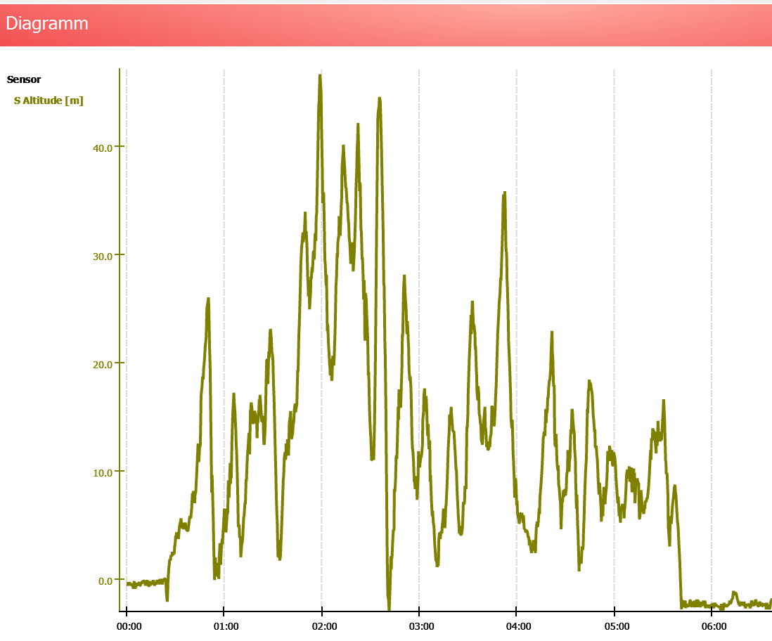

After upgrading from 3.3.3 to 3.4.0 altitude values are wrong. Way to low.
Wrong on the telemetrydisplay on the jeti remote controller.
Also wrong on the jeti log chartviewer on the jeti remote controller (DS16)
Also wrong in jetistudio.
I attach two screenshots from jetistudio, one before upgrading to 3.4.0 and one after the update.
As always thanks for your help
Sacha
Altitude on v3.4.0
Altitude on v3.4.0
Altitude on v 3.3.3 (Correct)

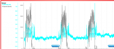

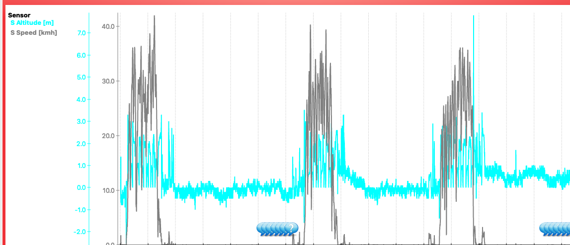

As i read this post, i found out that i have the same Problem. After update Spirit System GTR to 3.4.0 including the radiocontroll software (BIN)
Altitude values are definitly wrong. My messurments in the log was between +-/4m what can't be truth.
Before the 3.4.0 Spirit update, all values were ok.
So any Guys have the same Problem ?

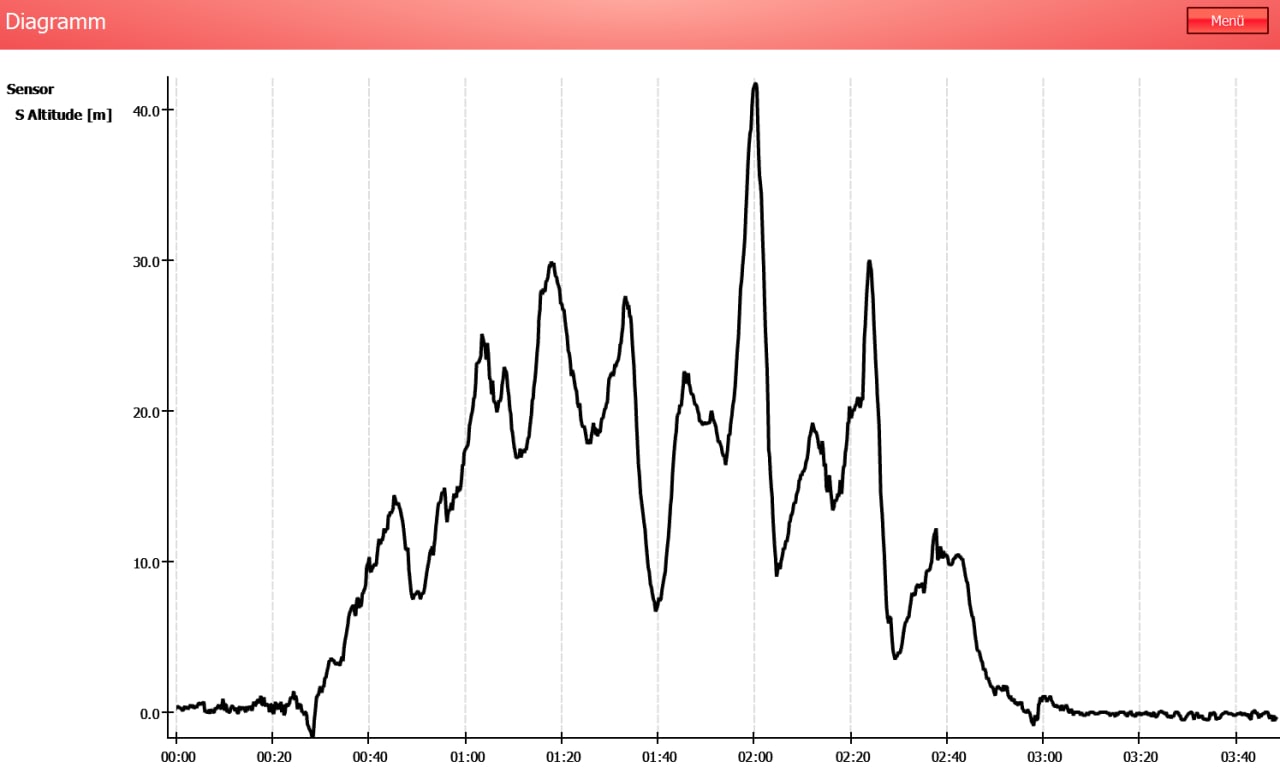

In my debugging process i disabled the geolink in the spirit GTR configuration.
As you can see on the screenshot, altitude values are normal again.
Summery for 3.4.0
Spirit GTR + Geolink:
Speed, lon and lat values are ok.
Altitude: broken
Spirit GTR without Geolink:
Altitude: ok
Other values not available because geolink is not used anymore.
I hope there will be soon a fix available.
