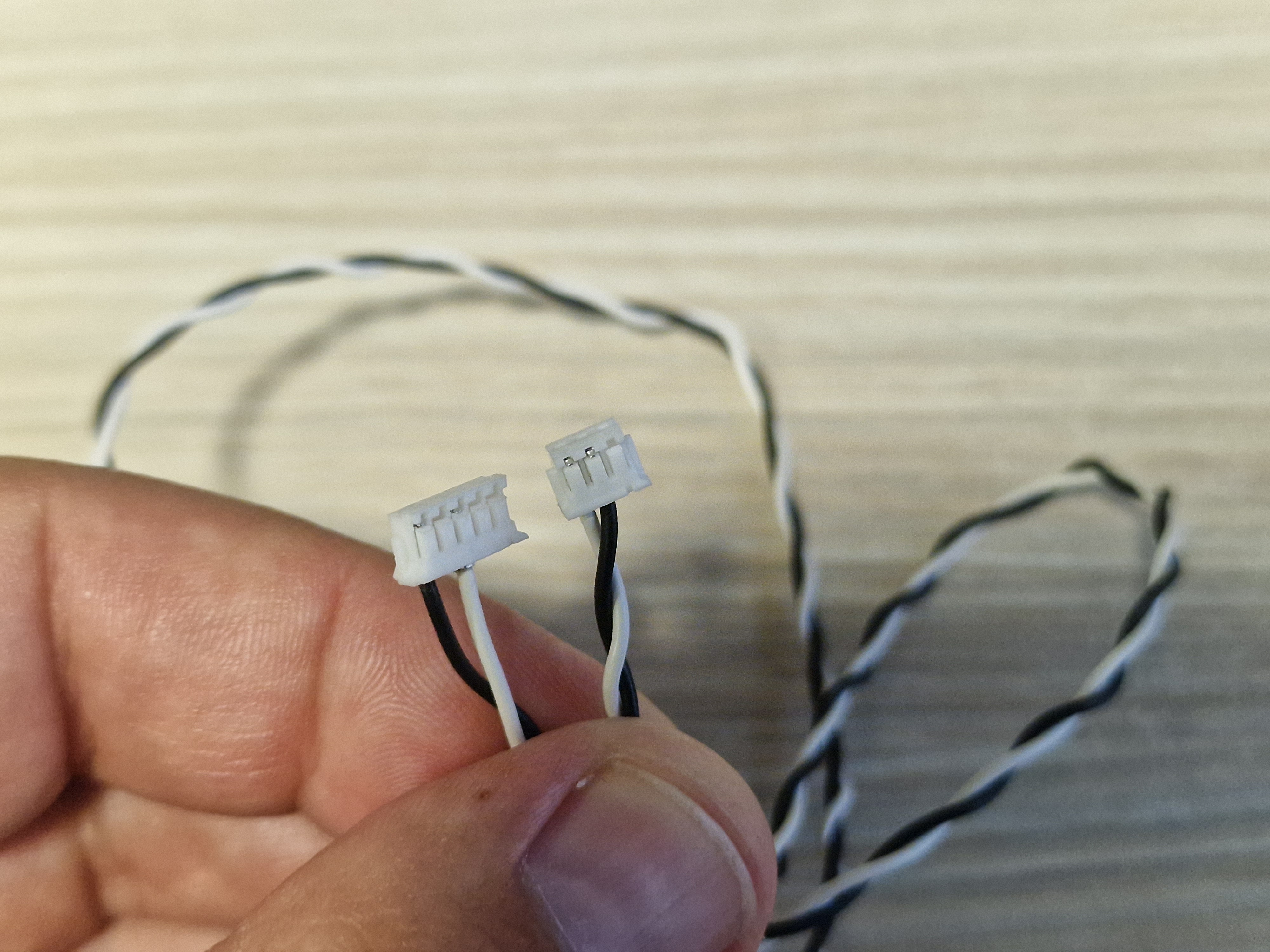

Hi. Maybe somebody can help me.
I just unpacked Kosmik 210 HV-I and it has some telemetry cables included. Especially one of them looks great, because it has spirit satellite port connector on one end, and Kosmik connector on the other.
But connections on the "Kosmik" side look different than what Spirit manual advices (and what I used in the past for Kosmik 200 not "-I"). Signal is on the middle pin.
I know "HV-I" has some "telemetry" extensions and maybe they made some changes, so wondering what cable to use now? And which port, out of 3, to use in Kosmik? Spirit manual doesn't have "HV-I"
I know I can try but would rather not burn the unit by connecting power to wrong place...

Hi, I was actually wondering about the same.
I could not find a Kontronik pinout description. It could be that the cable works as is if for instance there are multiple ground pins in the connector. Since I did not want to take the chance, I just moved the black pin on the Kontronik side to match the custom Spirit cable. If looking at the connector on the Kontronik end from "behind" as you would when plugging it in, the black cable is to the far left (let us call that pin 1). The Spirit cable has the black cable adjecent to the white cable on the right side (pin 4).
You may know how to move the cable without breaking the connector. If not it is really quite simple. Take a small pin (sewing needle works well), lift the small tab locking the pin just a little bit and pull the cable carefully out. Then insert the cable in the desired slot carefully paying attention to the orientation of the cable. It should have the metal piece with the small "dimple" on top as this is what allows the tab to lock the pin.
The above should only take a few minutes, but double check carefully. And then you will enjoy telemetry

Ok, now I see that signal is on middle PIN in both. So it's just ground different. I'll test it (will measure first to make sure I don't connect +5 to GND or sth..)
In manual they write that middle port is for Futaba or FrSky.
left and right ports can be configured and support a variety of protocols, including "Kontronik" which they write is needed for MSH Brain.
So it would be interesting to know what protocol is Spirit actually using...
But in any case, probably middle port will work if it worked in 200 HV.
I got this working, but it was trial and error...
What works:
- cable not modified (so I'm using a cable that comes with Kosmik 210 HV-I without changes)
- cable connected to the left port (the one on BEC connections side)
- in Kontronik software, this port protocol is configured as "Kontronik" and the right port (LED side) is configured as something else.
If both were configured as "Kontronik" it didn't work. Also connecting to middle port, and selecting Futaba or Frsky didn't work.
