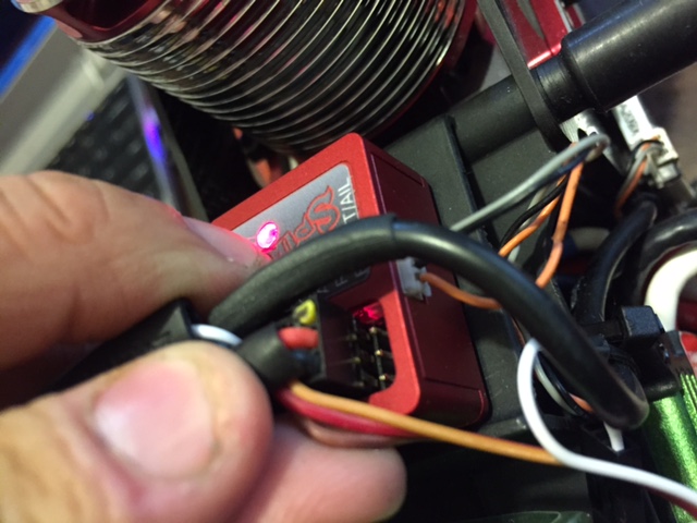

the setup is 100% what comes in the KIT of the trex 600L dominator
I use one DSMx sattelite connected at the side of the spirit
you can see the log, but it is not the flight one, because i power off the heli after the crash and then I power one maybe 2 or 3 times to make some testing

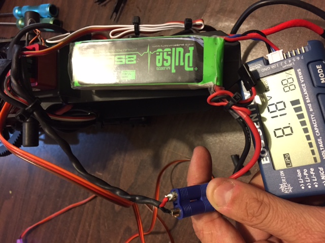

REceiver battery is a 2s lipo, and it has 88% full. see the photos of the setup. the wire is 20awg.

Spektrum cables are sometimes faulty even they are new, so flying with only one satellite on this helicopter size may be very dangerous. I highly recommend using second satellite or classic receiver.

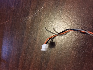

yesterday, taking apart the sattelite of the crahsed 600L kit, one cable cut off, maybe this was the problem, maybe it was coneccted with a one hair !!!
I will reassemble all with a AR8000 and dsmx sattelite (conventional receiver) and see

Oh, thats sad.
Great you have found it.
These cables can cause even short, they are very fragile so extra attention must be paid. Especially when you want to plug off the connector, it should be done always by pulling the connector only (which is sometimes hard too).
