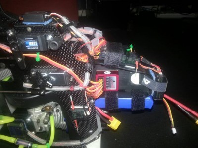

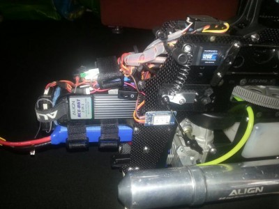

Went with this in the end, one question will it be OK to fly with the Bluetooth plugged in? It would be awesome if I could see real time vibe logs in the air ...
Posts: 12960
Good,
you can leave it as on the photo, but flying with BT powered is not recommended. It may cause interference with your transmitter/receiver signal and also is not safe. It can crash when settings are changed to incorrect.
Note: Vibration analysis can't be done in the flight. Servos are locked, so the measurement can be very precise then.
For this purpose you can use Flight Log witch will tell you if vibrations are too high during the flight.
shadowraven213
Posts: 10
Joined: Sun 15. Mar 2015 23:11:17
I'll put a little inline micro switch on it then, leaving it unpowered plugged into sys port won't be a problem will it?
Posts: 12960
Yes, it would be perfect with the switch.

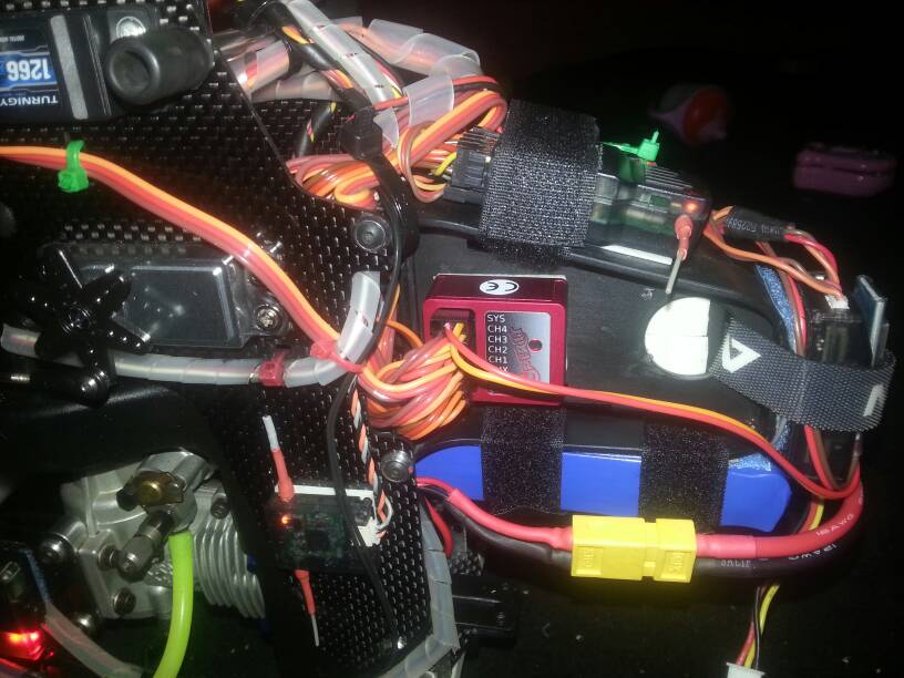

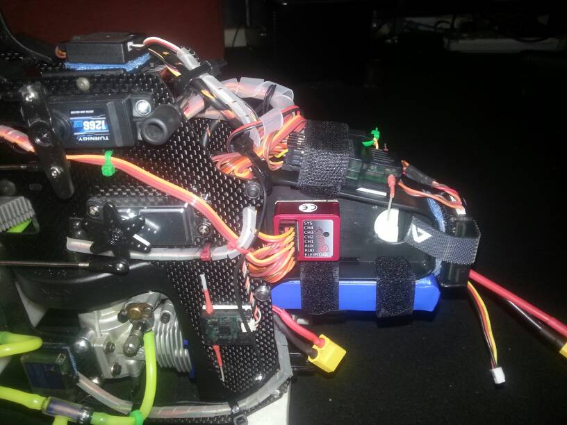

shadowraven213
Posts: 10
Thought you might like to see it finished
