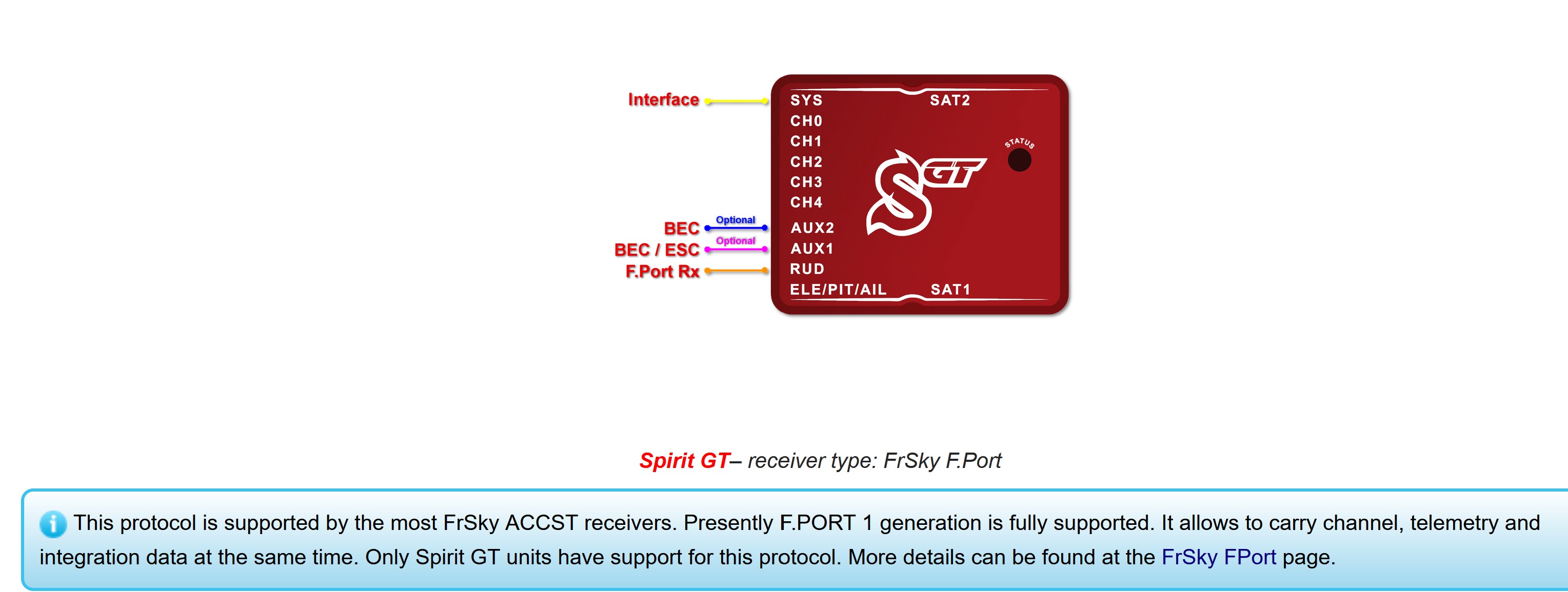

I have a problem to get the telemetry variables by useing FPort1 Firmware for R161 Receiver...
http://manual.spirit-system.com/index.p ... rSky_FPort
Connection to Hobbywing ESC Platinum V4 120 A as described here:
http://manual.spirit-system.com/index.p ... _Telemetry
I get some telemetry variables only from the receiver RSSI, TQly, A2 etc. but not as wanted the telemetry variables from the ESC as :
RPM [RPM] - Current RPM from the Governor.
Fuel [%] - Vibrations of the model (Reported as Fuel)
RB1V [V] - Main Battery Voltage
RB1A [A] - Main Battery Current
RB1C [mAh] - Main Battery Consumed Capacity
RB2C [V] - BEC Voltage (10x) - set Ratio 25.5
Tmp1 [°C] - ESC Temperature
5120 [μs] - Throttle PWM Value
Did I accidentally forget another connection?

Hi. I got ACCST F.port1 up and running. Did you enable telemetry in ESC menu?

Though my experience is with the FCC firmware, I found that the R161 V1 (ACCST V1) F.Port firmware does not have telemetry working correctly. You should try the V2 (ACCST V2, so FrSkyX2 in the TX16S protocol menu) F.Port firmware. Both are still F.Port v1.
