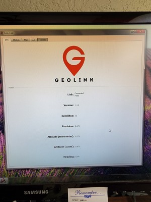

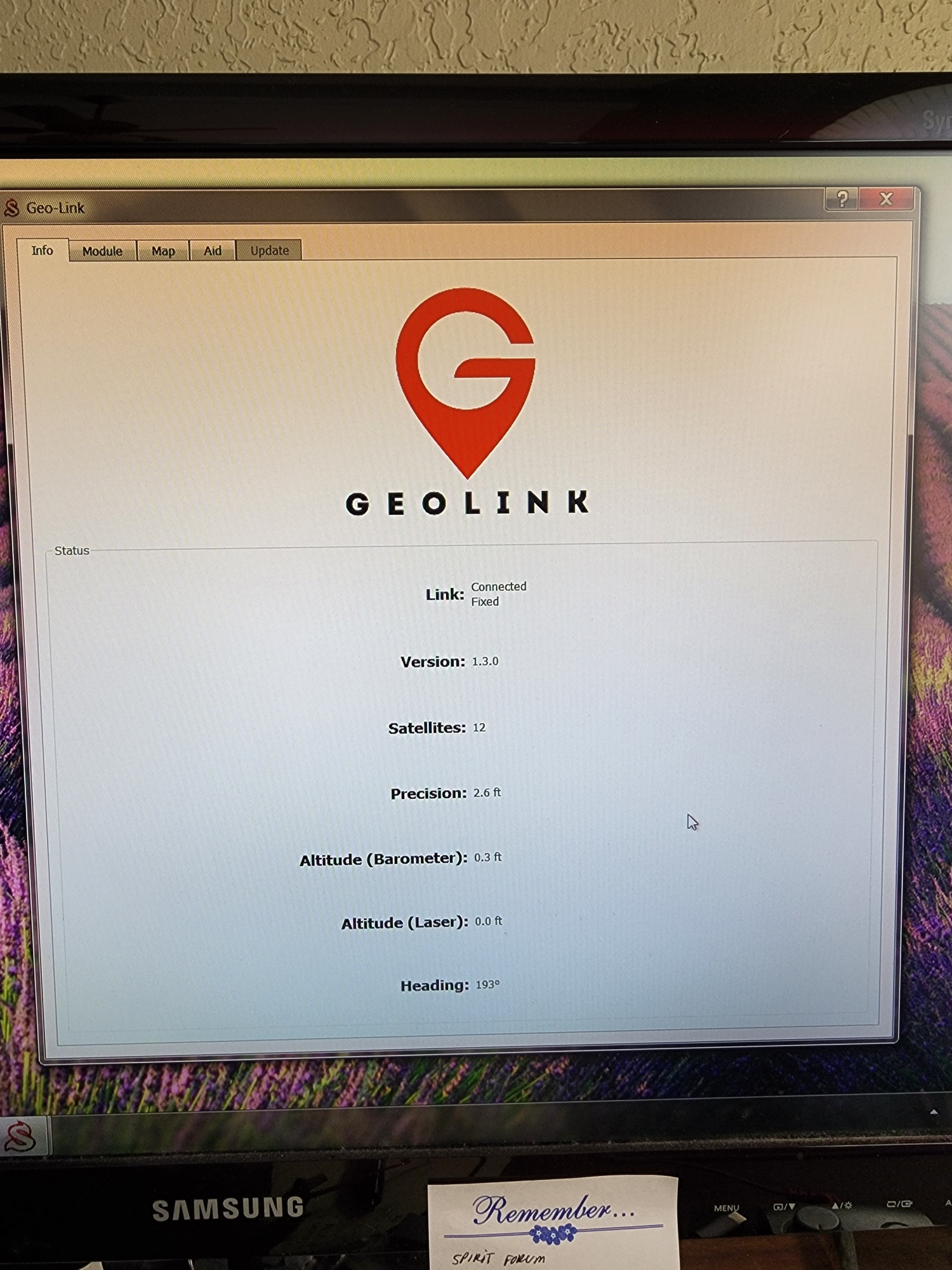

I have a spirit gt upgraded to ver 3.4.2. and Geo Link v2. The update button on geolink page is grayed out, ver 1.3.0 in installed. Can't install ver 1.3.1

it's upgraded to 3.4.2 the geo link update is still grayed out. i've tried windows 10 and windows 7. the geo link info page shows Altitude (laser) so i know its a V2.

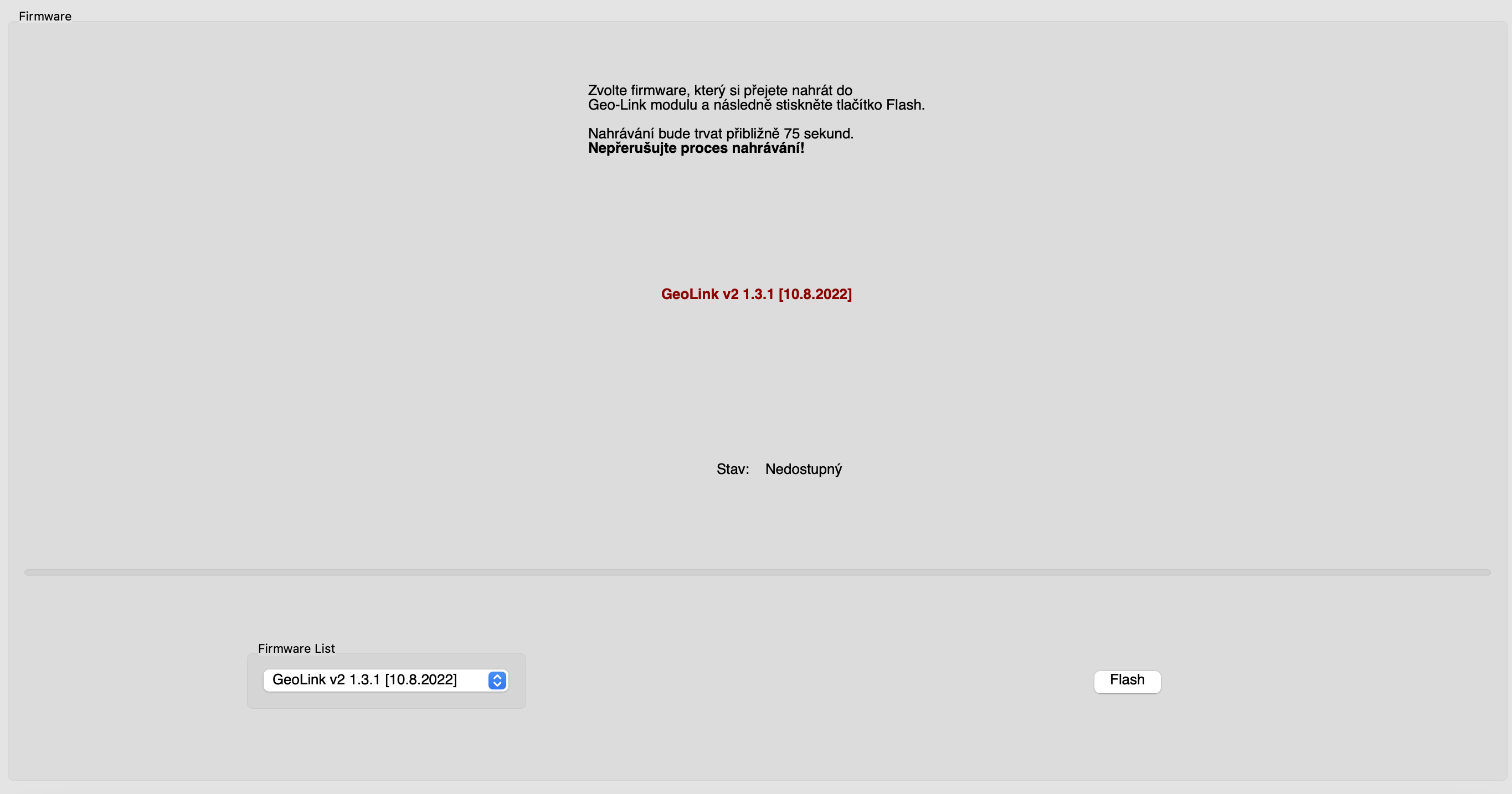

Posts: 13049
Please check the attachment how it should look like.
Is this similar to yours?
If not, you are still on 3.4.1. You have to see Firmware List.

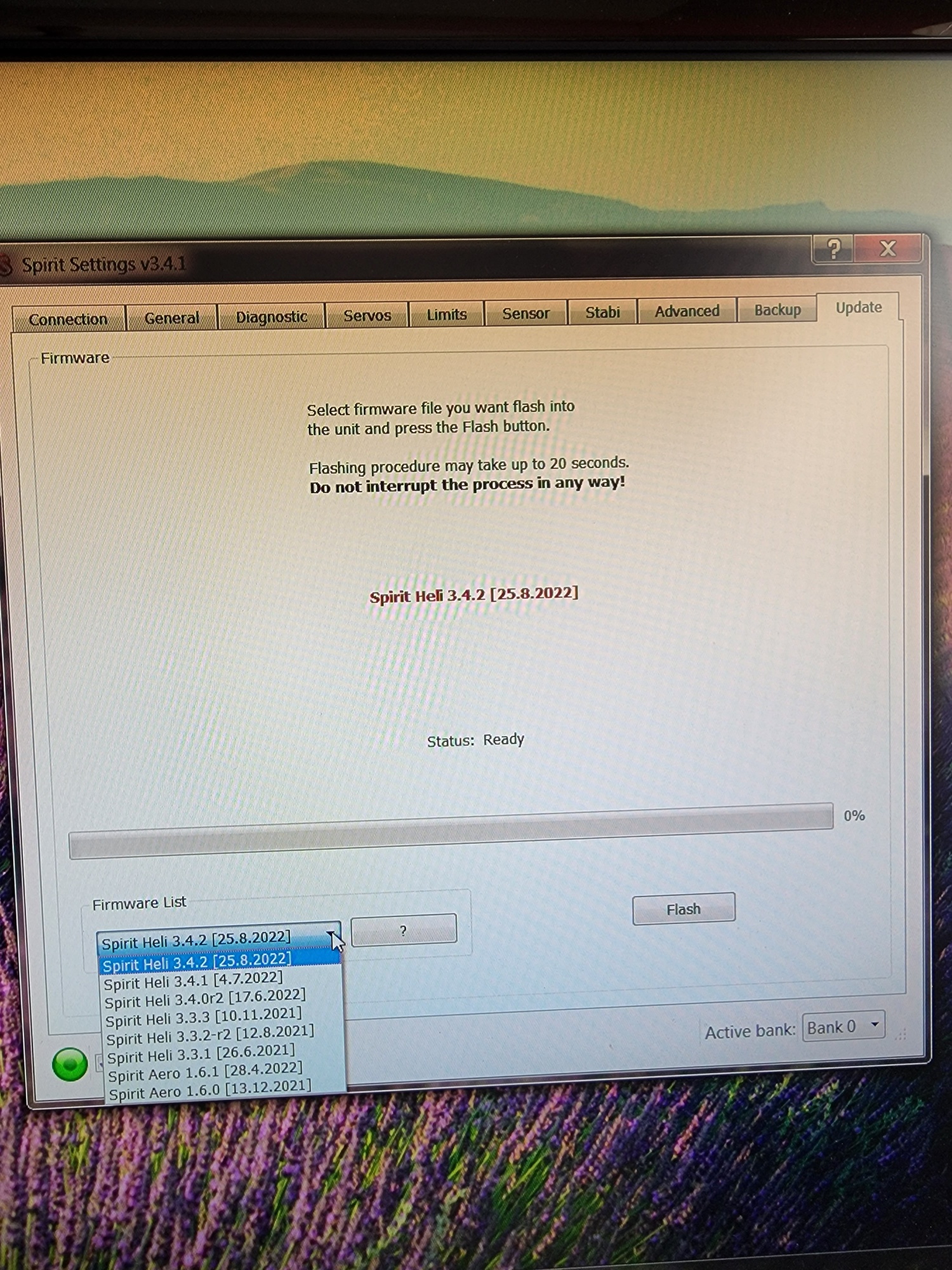

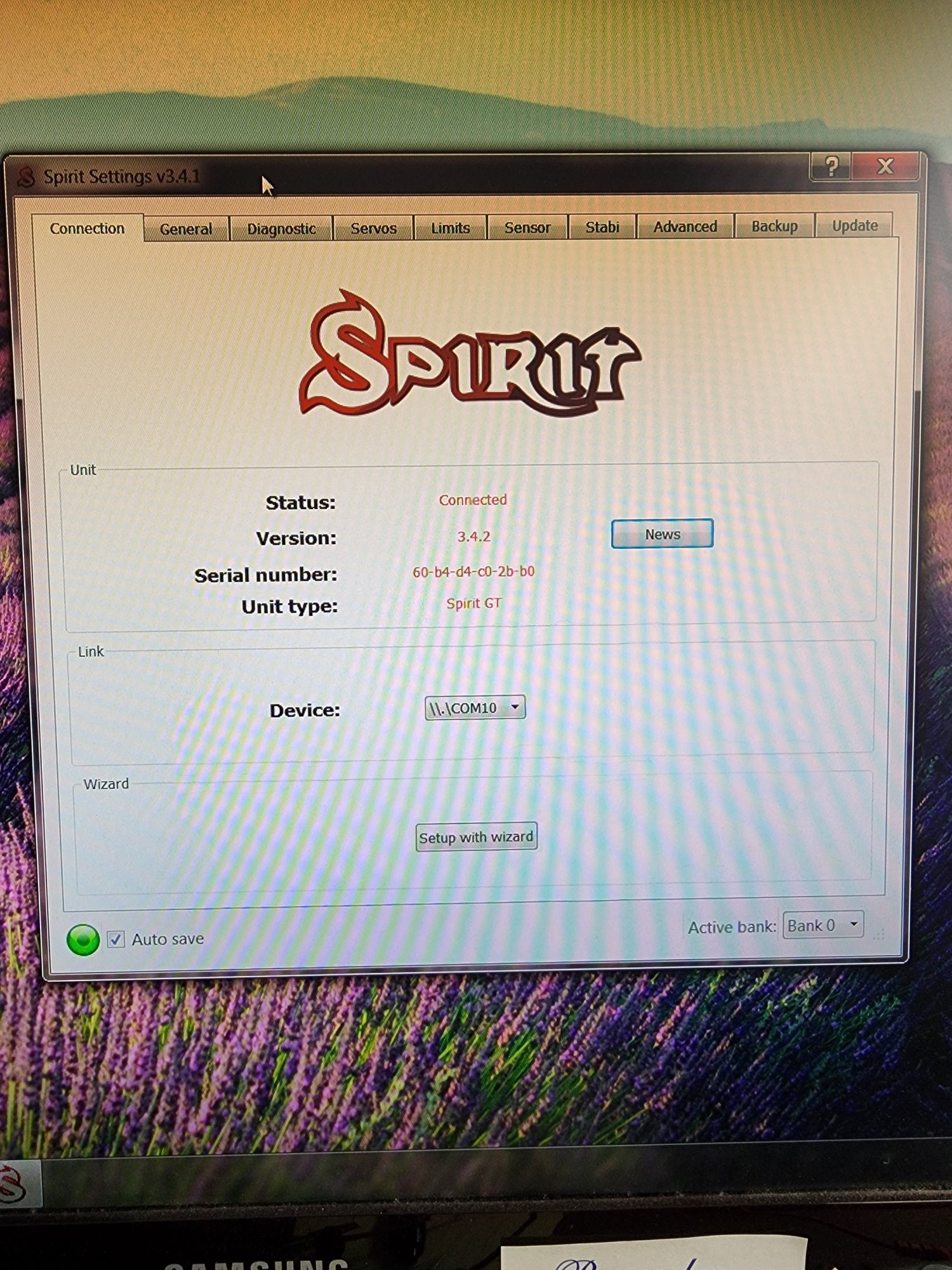

Here are screen shots let me know if anything else is needed. Thanks

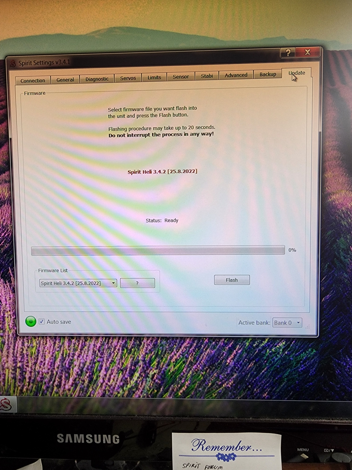

One more

Posts: 13049
Thank you.
It is clearly visible you are using still old software 3.4.1. It is visible at the Window title.
Please download and install new 3.4.2 from our web page.
After installation of the latest software you will be able to do GeoLink update too.
