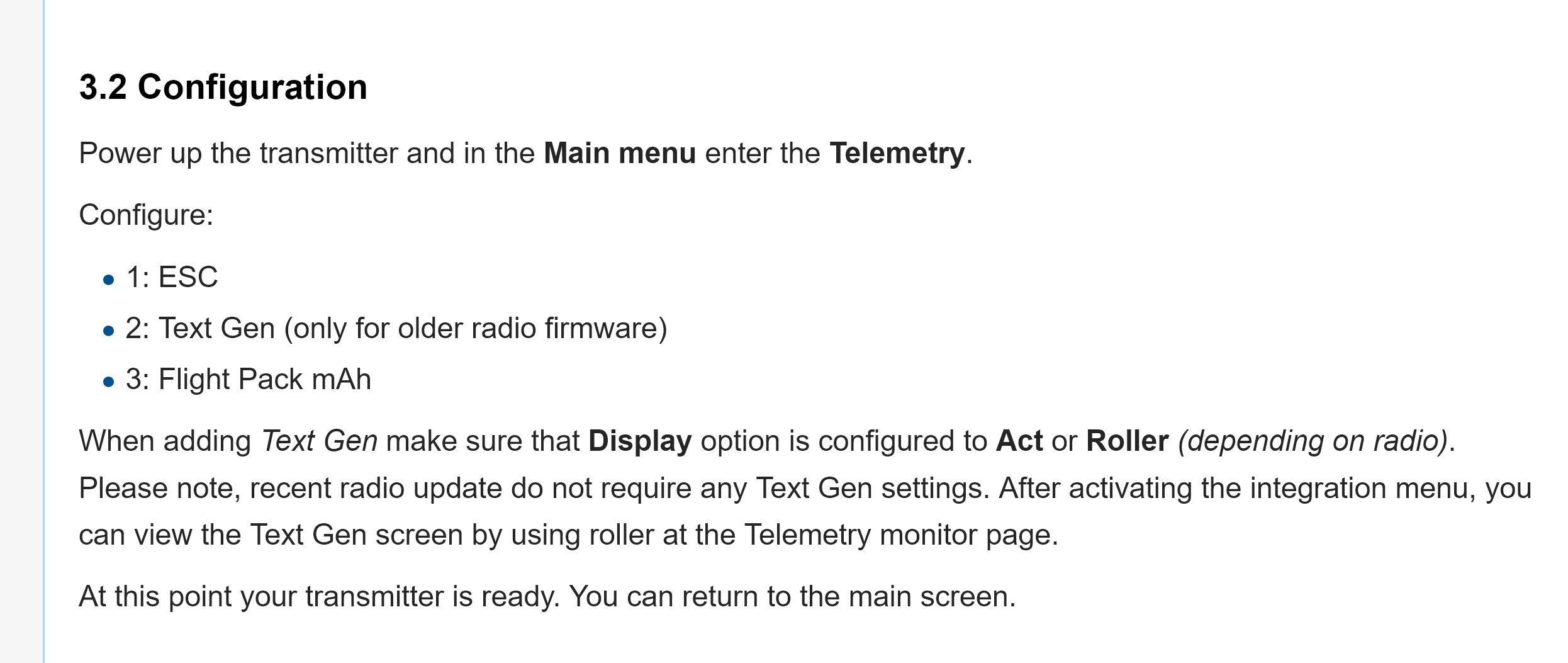

I am using an NX10 with SRXL satellite.
Manual says to set 1: to ESC. Not an option in TX.
Have the Telem UNI Cable connected from ESC to Sat 1 port per manual

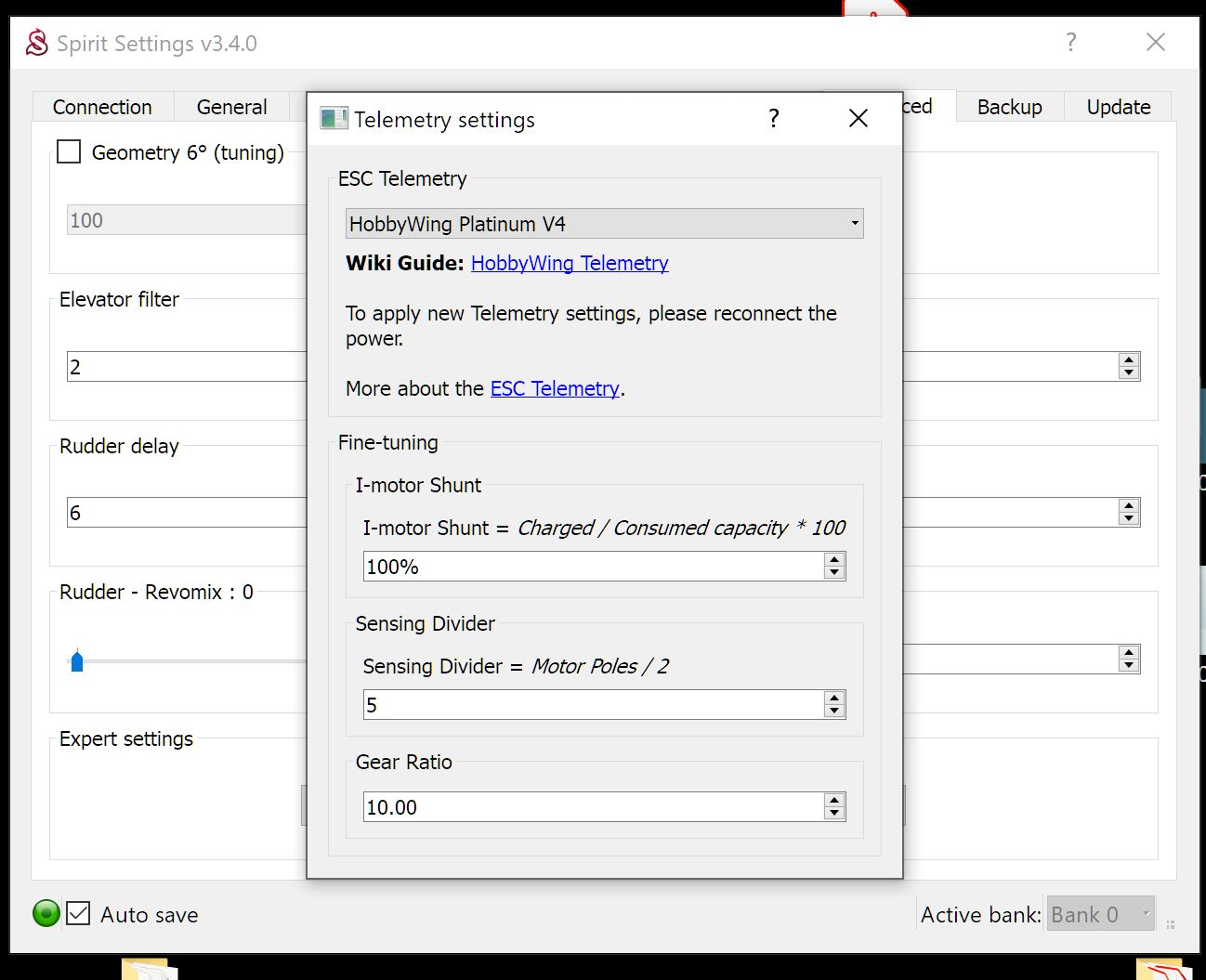

Thu 08. Sep 2022 9:53:27
please leave transmitter Gear Ratio in default settings.
This should be fine. Is there anything else wrong?
