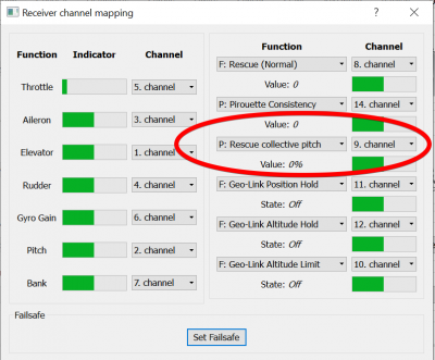

I have set the "F:rescue( normal)" to channel 8
I have set the "P:rescue collective pitch" to channel 9
I have set the "F:Altitude Limit" to channel 10

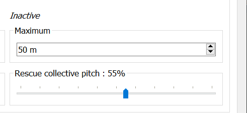

My Question: Is the "Rescue collective pitch" for the "Altitude Limit function" variable to Channel 9 setting or is it fix to the value set in Geolink parameter sheet for instance 55%.
Is the channel 9 value for both functions: "F:Altitude Limit" and "P:Rescue (normal)"
Thanks for your help
Geo-Link 2022-09-08 14.56.25.png (5.23 KiB) Viewed 1749 times

the value is for both. You can check it simply even at the ground.
